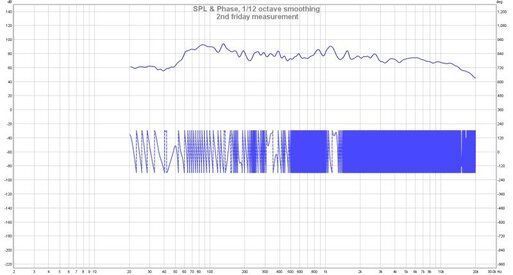

And could someone decipher that graph, please? Thanks
Not quite time to celebrate yet, the measurement looks like noise.

Are you getting signals from REW to your system now? If you open the REW signal generator and play a 1 kHz sine wave do you hear the tone through your speakers? The output you have selected claims to be a digital connection, but you indicated earlier you were using an RCA cable to link to your system, sounded like that was an analog link.
You have something called 7028574.txt.cal loaded as a soundcard cal file, which also looks to contain noise. You should clear that file.

Any better?
corrected measurements
How are these? Fingers crossed.
Looks a lot more plausible! Try setting 45 dB as the bottom SPL value and 105 dB as the top.

That isn't a valid measurement I'm afraid.
It is REW's soundcard preference settings I was after - there is always some kind of soundcard involved, whether internal or external. Your file shows you are using the ASIO4All driver and that the input is the built-in mic input of your PC. I suggest you use the Java drivers, there is no reason to use ASIO with your setup. There is no sign of the UMIK-1, which is a USB device. Just to make sure we are talking about the same thing, this is a UMIK-1:
To make meaningful progress the input and output selections and connections have to be correct. You need to be able to generate sound on the system using the signal generator and see the UMIK-1 in the input list.
