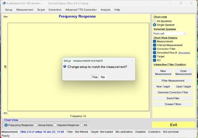

Just trying to think this through. I’ve measured my system as a 5.1.2 format for Dolby Atmos audio but would like to separately create two stereo filters with 2.0 and 2.1. Do I need to separately measure or can I extract the measurements for the mains and sub, and use the timing reference, from my multichannel measurements? Thanks. JCR
You should be able to, using different playback settings in the speaker configuration. Ie 2.0 content could be routed to 2 front l/r and sub.
So I would have thought as well. However, after setting up a 2.0 speaker setup (full range for my mains, without subs), I get the error message when opening the 5.1.2 measurement, asking if I want to change the setup to match the measurement. When I say no, then the setup stays as 2.0, but the measurement does not open.

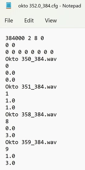

I do note that when I save a 5.1.2 filter set, Audiolense also automatically generates cfg files for 2.0 and 5.1. However, as you can see, it's not actually 2.0. It looks to me to be 2.1 even though labeled by Audiolense as 2.0. What would be the effect of using these cfg instructions -- 2.1, leaving the five other channels running but unconvolved? This, as compared to 2.1 and the other channels are disabled. And, of course, this doesn't get me to 2.0.
Further thoughts appreciated. Thanks. JCR

I follow, Bernt, but don’t understand the execution. Let’s take the simple 2.0 format for my mains alone. How do I create or identify the 2.0 cfg file off of a measurement set of eight channels? As shown above, the “2.0” cfg is really 2.1. Is it as simple as assigning the 350_384.wav file to my left main and the 351_384.wav file to my right main, and that will send full range out to each main? Or, as the eight channel setup routes bass below 40Hz to the sub, do these two wav files only represent full range above the 40Hz crossover point? JCR
