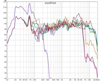

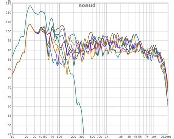

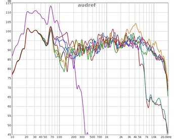

I've measured my 7 bed layer of my 7.1.6 (Denon X8500H) 3 times. Without Audessey, Flat, and Ref(erence). I'll note that I need to investigate why Flat and Reference are killing highs on my RSL, RSR and Center (odd...) but without Audyssey active the speakers don't have the drop out above 10k.
Room is heavily treated with FR703. (It's below a garage so all 6 surfaces are 12" concrete). 4" ceiling (false ceiling covered in stretched cotton fabric), 4" most of the back wall, 1" side walls up to ear level, and 2" front wall. There are also 2'x2'x9' triangle bass traps in the front corners behind an AT screen. It's taken a 6 second flutter to about 140ms with all this treatment.
Speakers are LCR RBH 661se, surround 44se, rear 61se, and 2 subs Rythmik 15" sealed subs in boxes I built and placed next to L and R. All speakers set to small with crossovers at 80hz.
My questions are:
  1. The mic was kept in the same location for all speaker location tests. What can be gained from doing this and using multiple speakers vs a single speaker and multiple mic locations? fyi, I didn't move it yet because I wanted tests to be reproducible as I learned REW. I do plan to go back and test multiple mic positions for each L, C and R (and others if it would be useful) but I thought that all speakers might be a good start?
  2. Are these good or bad results? I've looked around and seen some much worse but I've also seen a lot better but it's hard to know where I'm fitting.
  3. Is it normal for speakers to be so jagged (?comb?) like these as these graphs show, even near close hz ranges?
  4. Any thoughts on what can cause the drop in 100-300hz and some ideas on where to look to fix it?
  5. I'm not sure why when testing just LFE the db is far higher than with speakers, I think it's because when running with other speakers the avr is bass managing it so really only the LFE test itself is showing the true possible output of the LFE?
  6. Other comments on graphs or suggestions on what I should be looking at adjusting for speaker angles, room treatment, audyssey adjustments, sub PEQ, etc?

You are running version 5.19 of REW. You should consider updating to the latest release candidate, 5.20RC5, as @John Mulcahy has done a great job of adding more tools to REW since 5.19 was released.
If you are only concerrned about the Main Listening Position (MLP), placing the mic in one position to do your measurements is fine. Measuring from multiple positions is a good way to determine how the low frequencies and modes in the room would be perceived by listeners at those other positions.
There are no good or bad results, per se, the measurements reveal how the room and how you have treated it effect the perceived sound quality. When doing your sweeps, you don't have to start every measurement from the single digits. Your subs are -30 dB at 10 Hz so there is little to be gained measuring any lower than that. In fact, with the response that far down, you will be measuring the LF noise in the room and not the speakers. When doing your measurements, try to measure at a reasonable listening level of around 75dB at your MLP. Audyssey will do its calibration at that level and it's probably more comfortable and less of a hazard to your ears if you're not measuring at 95 dB.
Additionally, when measuring the subs, you really don't have to measure out to 20 KHz as, again, the response is so far down you'll only be measuring noise. 500 Hz is good enough. Don't apply any smoothing to your sub measurements.

3. Is it normal for speakers to be so jagged (comb?) like these as these graphs show, even near close hz ranges?
Even in the best of treated rooms there are always reflections from surfaces, diffraction from the corners of cabinets, and environmental noise that will show up in your measurements. Remember that the mic is much more sensitive than your ears and will pickup things that you can't possible hear. Keep in mind that the ear/brain system of hearing integrates out a lot of the things you see in these measurements.
This could be a timing issue with the mains. If you can't move the subs around you can adjust the distance settings in your AVR to change the timing to see if you can fill in the low spots.
39124
There is a drop in the response at around 56 Hz to 58 Hz that is probably a room mode:
39129
That might be hard to fix if you can't move the subs around.
The LFE (Low Frequency Effects) channel is a separate channel that has a higher output, +10 dB, and a separate crossover frequency, 120 Hz, than the bass management settings for the main speakers. You can use the LFE channel to test with when choosing positions for the subwoofers to reduce the effects of room modes on the bass response.

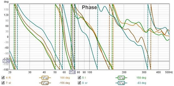

Your SR (from 70Hz onwards) and SL (from 200 Hz) are out of phase with the rest of the speakers (see attached). This is causing the dip between 100-300Hz. Since I checked phase overlays from noaud measurements, this can't be filter related. They might have faulty crossovers. SBR SBL and C all seem fine.
The sharp drop around 59 hz Sam has pointed out is speaker boundary interference. I am guessing your front speakers are 125-130 cm away from the front wall which is causing that dip. Your speakers lower bas limit is 50 Hz which has 1/4 wavelength of 150 cm. So if you can move your front speakers 25-30 cm further away from the front wall (I know easier said than done!) this dip will fall below the speakers bass capacity and disappear.
