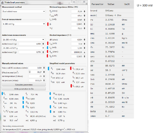

Thank you. The picture shows two tables of TS parameters created based on the same data. Left from REW, right from Speakerbench. I highlighted a small discrepancy in blue, and a large discrepancy in red. Is there anything that can be done to ensure that the parameters marked in red match closely?
A lot of parameters have significantly more resolution than seems appropriate. Some measured parameters likely have a significant accuracy tolerance, depending on how the measurement was taken, and with what means, and whether the measurement was done at an appropriate location (eg. the voice coil resistance). It almost suggests the need to use a monte carlo simulation to appreciate what range a calculated parameter could end up with.
