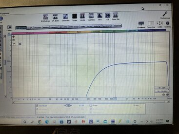

I'm embarrassed to admit it it, but I've taking REW measurements for some time now, and somehow never bothered to do the soundcard calibration step!
So anyway, I finally did it and this is what I got (see image below, cal file attached).
I did not get any error message, but compared to the examples in the helpfile, the rolloff at low frequency seems huge!
Is this okay to use this or do I have a problem to solve?

It appears to have a 170 Hz first order high pass applied to it, which isn't OK. You are using quite an old REW build, you could try the 5.20.13 current release and choose the device entries that start EXCL to use WASAPI exclusive drivers, that may bypass any Windows processing. Otherwise check what processing may be applied elsewhere in the measurement path.

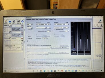

I downloaded the 5.20.13 release. I can make measurements using either the default drivers or the EXCL drivers, but, when I try to calibrate the soundcard, the "next/cancel" buttons never appear. What might be causing that?

John,
Here is what it looks like:
I tried changing the Input and Loopback inputs (L/R) to both R, but the result was the same. No "Next" button appears.

Veleric
Sep 22, 2019
34
John,
Okay, hitting the space bar works to advance through the steps, until I have the input level set. Then when I press the space bar nothing happens....

7,358
If you interact with any other controls the next button will no longer have focus.

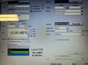

I got the Startech Interface and the Umik-1 mic and have successfully loaded the cal file, set up the inputs and outputs, and made measurements. All seems to be working as expected there.
Then I was curious how the results with the Umik-1 would compare with the Dayton imm-6 mic that that I had been using previously.

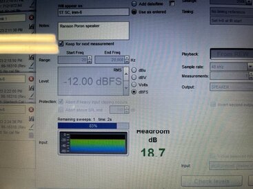

I was also able to make measurements with the imm-6 mic (also using the Startech interface), and the results were quite similar (virtually identical) to those with the Umik-1. But the one thing that was odd is that when I ran a sweep using the imm-6, the meter display graph on the bottom left of the measurements page shows no increase in the input signal during the sweep measurement. Likewise, duing the "check level" test on the measurements page. That makes me wonder if something I've done in the setup is still not quite right. What would be the cause of that?
Thanks, Eric
