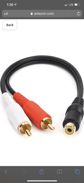

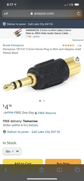

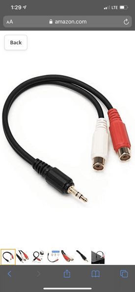

To measure the sub alone you may have to disconnect it from the soundbar and connect it to an analog output, e.g. the headphone output of your computer or an output on an audio interface if you have one.
Would something like this work?
The 3.5mm to stereo RCA will work to provide access to the headphone outputs.
So I would plug that into the headphone jack on my laptop and then I would plug in my subs into the red rca connection?
