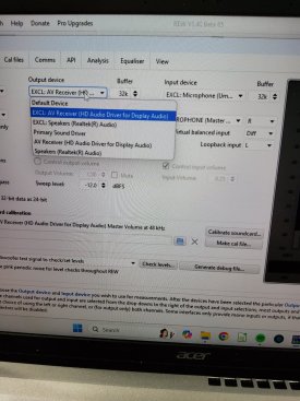

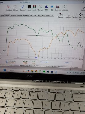

Hi, I went back to REW to twick my HT. Haven't done it for a while so I didn't change the output device în preferences. After a couple of hours of work I remembered about that, so I looked. I tried EXCL AVR and just AVR. The results are completely different. The green curve is with AVR and the yellow one is with EXCL. Both of them use the automatic Dirac live setup. Also, for EXCL I had to increase the volume by 15db. What the heck? Something must be really wrong. I believe the green line much more than the yellow line.
I also noticed something else. If I change the volume by 5 db, the EXCL curve doesn't slide by 5db everywhere. If I do the same thing with the AVR, the curve changes by 5db pretty much everywhere. I guess one more reason to not believe the EXCL results.

Exclusive WASAPI goes directly to your soundcard, while shared WASAPI goes through the windows audio mixer with all its features and DSP, whatever is configured. Including volume control.
So, why the direct sound card scenario would be messed up? I haven't made any changes to the sound card on my laptop. Do you know any setting in particular I should check?
The exclusive mode bypasses any volume control done by windows mixer. If its ouput has lower level than non-excl mode, then the windows mixer boosts the signal. It may do other things, depending on your DSP chain in the mixer.
