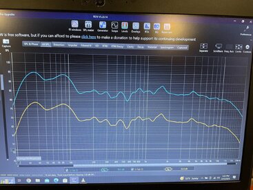

I'm still struggling with this concept. Are you familiar with Obsessive Compulsive Audiophile on YouTube? He is using your files and seeing no difference in SPL between the REW generated sweeps and your file sweeps. I have tried two different PCs, both W10 and W11, and the files play at lower output in all cases. For FL, REW sweep in blue, your file in yellow from VLC. How can he get them to play at the same level, but I cannot to save my life? :/
Perhaps @serko70 can respond to that directly.
The difference is only 6 dB on my system, with REW configured for -12 dBFS.

I finally found the culprit and explained in Youtube comments but I should also add it here for members:
Marantz/Denon line receiver's default setting "Loudness Management: On" applies an SPL offset to Atmos signals while it doesn't do that for any other signal ie REW sweeps. The setting should be turned off for calibration. Then all sweeps (@thothsong 's or REW's own) are identical bar a maximum 1.5dB disagreement between us with surround channels :)
