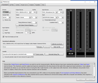

Alright, I'm not sure what's going on now. If I play ANY audio out on my laptop it goes through my speakers. However, if I generate a tone in REW - nothing. No sound. I'm attaching a screen shot of my preferences.

Also, I had to set the settings in my laptop to 5.1 in order to make it generate a sound to my sub. Should I set it back to stereo if I'm only running a left and a right as far as speakers go?
7,344
Your laptop's surround settings do not affect REW's output. How did you "generate a tone" in REW? If you used Check levels on the soundcard preferences follow the instructions in the help panel and press the "Next" button.
I used the "generator" function at the top of the main page.
Try setting your output to something that doesn't use exclusive mode. Look and see if you have an option for the device, but without EXCL in the name. You may also need to select the non-EXCL umik-1 also.
I think this was it! I selected the non-Exc option, which I didn't notice the first time. I now have sound through REW. I will attempt to take some measurements later when it's quieter around here. Thank you all for all of your help so far!
