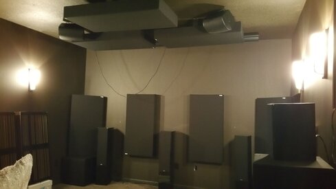

We really wanted to watch a movie last night, so I pulled out the third F36 for center, set up my pair of A1.4 as surrounds, did a quick and dirty Dirac calibration and sat down to watch the new(ish) Jumanji. I gotta say, it was great! That's the first time I've had surround sound since the theater came down 14 months ago.
The sound was very good, the video looked excellent and I was super happy with the whole thing. It's only going to get better after room treatments, subs with another octave of extension, a full 7.1.4 setup, and careful attention to placement, setup and calibration. I just wish I had a few full days with nothing else to do so I could get it done.

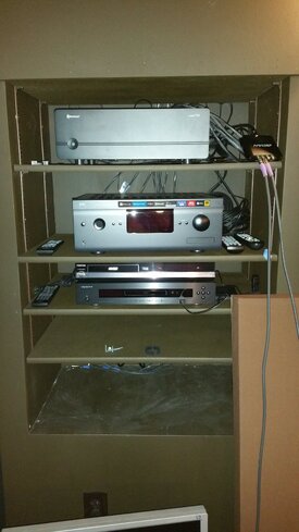

My "audio rack" (component closet) now has shelving in it, and I've installed all the equipment. I've also hung a few acoustical panels, and will continue to do so over the course of the week. I didn't get as much done over the holidays as I was hoping, but better than nothing.

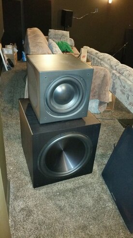

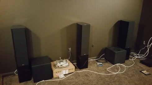

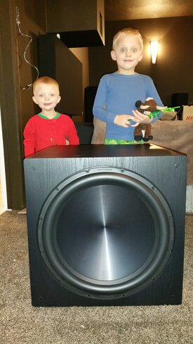

The Rythmik subs have landed! Got 'em unboxed, placed in potential locations, Dirac'd and had a brief listen to stereo sources last night. Nothing challenging at all, but they sounded good. Can't wait to unleash them with some truly demanding material. Measurements with REW show extension below 10 Hz, which is fantastic.
I will be doing lots of experimentation with placement to see what works best. Right now I have them on the centers of the front and back walls (well not quite center - my center channel speaker won't allow it, so I placed that one off-center to one side, and the back one off-center to the other side so they're symmetrical left-to-right). They are firing to the side walls to get the cones closer to the boundaries. I discovered with my old subs that these positions measure well, but oddly don't sound as good as both subs on the front wall 1/4 points (both positions Dirac'd). So I guess I'll be lugging the new ones around and doing lots of measurements.
See the pictures. Not sure why my son is wide-eyed on the one picture, but that's how my eyes probably looked when I saw how big these are haha. Also I've included a picture of the equipment installed on the new shelving. Also of note, my overhead speakers arrived at the house today, I'm told. Getting close !!!!

Very cool!
I don’t have extension below 10hz! Lucky man.

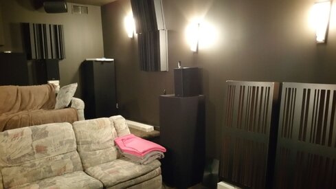

All right guys, I haven't said a word since January. I've been extremely busy at work and at home, so it's been hard to find time to forum much. Anyway, my system is mostly set up and running well. Acoustic treatments are sorta mostly in place, all the speakers are in place (though the sides and surrounds are not yet on their permanent stands), and I've been enjoying it quite a bit.
Things I've been doing
- Installing acoustic treatments, including painting diffusors by hand (probably 15 hours into the painting alone).
- Learning (trying to learn) video calibration and calibrating the projector.
- Playing around with sub placement, phase alignment and such (thank you, REW!) and integrating old subs with new Rythmiks.
- Dirac calibration (a handful of times) and playing around with target curves.
Still lots of little things to do:
- Install door seals on the two doors.
- Build stands for side and rear surrounds.
- Mount large bass traps (currently pulling duty as speaker stands haha).
- Mount side wall first reflection point treatments (currently leaning against the wall).
- Experiment with diffusor locations and permanently mount (I have some localized flutter echo issues to eliminate).
- Finish details on projector hush box.

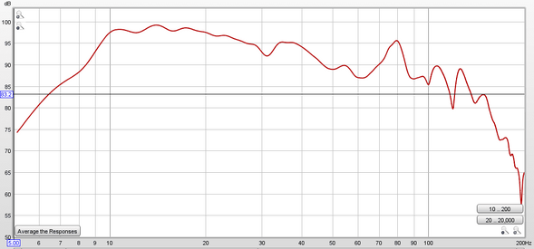

Just a tease, but here is my subwoofer response at the moment. This is before Dirac. I've got the Rythmiks in the front corners of the room, and my old subs (a pair of Phase Technology 12" passive radiator subs) playing as a single sub sitting right next to each other in the middle of the back wall. I've high-passed the Phase Techs hard at 30 Hz (48 dB per octave), since their output drops like a stone below there and I don't want them limiting my output too much. I was hoping to smooth out response above 30 Hz by doing this. A miniDSP 2x4 and many REW measurements were used to arrive at the best phase alignment.
Previously I ran with the Rythmiks alone, in the front left and back right corners of the room. It worked pretty well, but I didn't keep a measurement of that unfortunately, so I will have to measure it again.

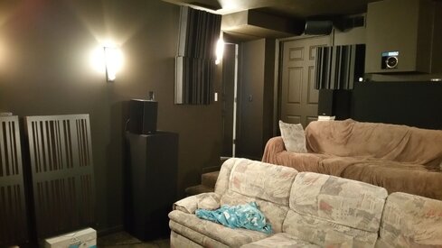

And here are a few pictures of the current state of things.
