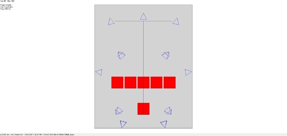

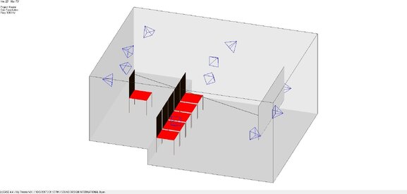

Some plan views and conceptual views of the theater space. Not fully complete, but you get the idea.

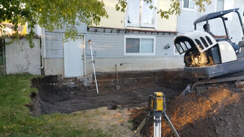

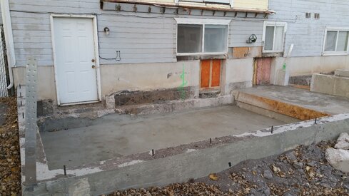

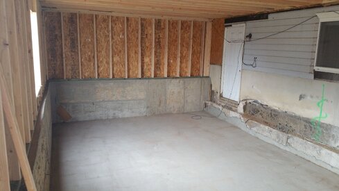

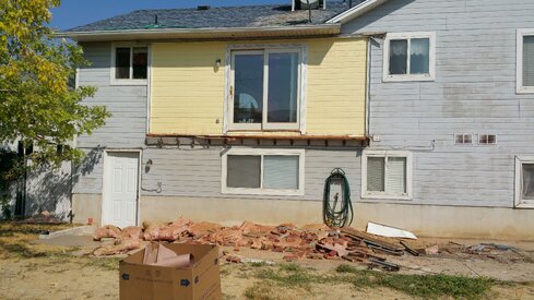

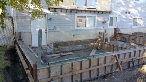

We ripped off the sunroom in early September, to make way for the addition. Excavation started September 29. The floor of the theater will be on the ground you see in the excavation picture. The door to the theater will be the left cutout in the "Foundation Done" picture (existing white door will go away).

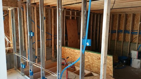

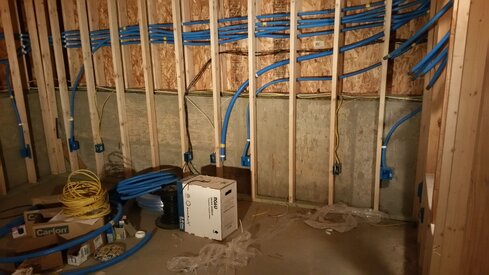

Edit 2/3/18: Pictures added of walls with wiring, conduit, just before insulation.
