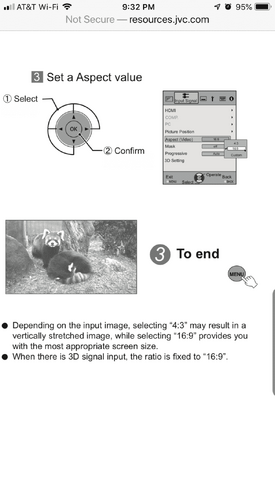

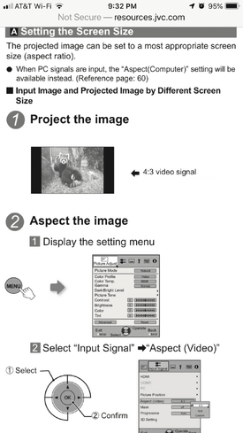

Even after reading more about screen aspect ratios versus image aspect ratios, I’m still struggling with how the projector knows the difference between the two screen sizes.
So is the X70 capable of throwing a CinemaScope picture? I wouldn’t be disappointed if it couldn’t. I believe I’ll still prefer the larger 16:9 image area on a 16:9 screen. In any case, my manual is of little help:

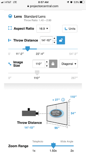

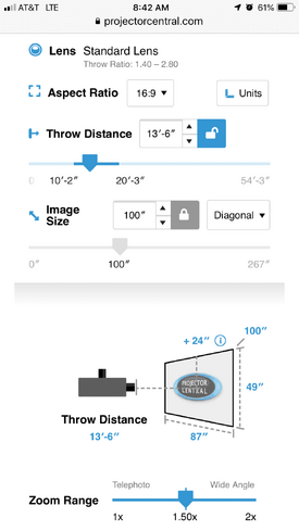

And now to nail down screen specifics. My projector’s manual doesn’t include a throw ratio, so I got it from projectorcentral.com along with a really nifty calculator! I ran a few scenarios to get the feel for the effects of projector distance and lens zoom. Now I’m worried. My screen is only 13’ from the back wall, and my viewing distance is likewise fixed at approximately 10.5’.
For a 100” diag 16:9 screen at 1.5x zoom, the calculator yields a throw distance of 13’ 6” (outside the room). Increasing the zoom to a maximum of 2.0x decreases throw to 10’ 2”. Likewise for a 110” diag 16:9 screen at 1.5x zoom, throw distance is once again outside the room at 14’ 1”. Increasing my to 2.0x zoom reduces throw to 11’ 2”.
QUESTION: Which is better, maximize screen size and projector distance knowing it will be operated at 2.0x zoom? Or slightly reduce screen size for same max projector distance knowing that lens can be reduced from maximum 2.0x zoom?
EDIT: I've since discovered screen distance recommendations in the X70 manual which differ from the above calculator (which is based on a non-published projector throw ratio). Recommended mounting distance from a 100" screen varies between 9' 11" and 20' 1". Recommended distance from a 110" screen varies between 10' 10" and 22' 2". Maybe it's time to call a dealer or JVC Customer Support.
There is no decline in picture quality by having the projector closer to the screen. There is an increase of available light though, which is a good thing.
Remember you're calculating distance from the LENS to the screen which takes into account length of projector and required clearance from back of projector to wall.
Thanks, I’d forgotten about increased light at closer range. My low-output X70 needs all the help it can get.
To clarify though, my question should be asked in multiple parts:
  1. Should max zoom be avoided on JVC models? I’ve heard that zooming can cause artifacts.
  2. How do I determine the actual throw ratio—or equivalent screen distances? The manual is at odds with distance calculator.
Leaving one foot clearance to the back wall for cabling, ventilation, & curtains puts the lens face another 18.8” away. The maximum distance from screen to lens would then be:
Throw Distance = Lroom(max) - Screen Offset(min) - Lens Offset(min)
Max Throw Distance = 17’ - 4’ - 2.6’ = 12.4’
According to my previous posts, the image should be large enough to fill a 100”-110” diag screen with the projector lens at around 12.5’ but using close to max zoom.
EDIT: Corrected throw from 11.4 to 12.4
