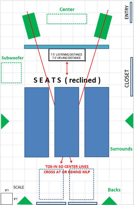

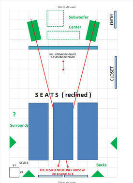

Thank you everyone for your help! Along with some discussion going on in my main build thread, you’ve helped me decide on a drop-down AT screen.
My most generous wife agreed to a single row of 3 seats, so speaker placement for best 2-ch performance has a fighting chance. The theory worked out in that main thread will most likely need adjustments, but there’s really not much room to make a difference no matter which speaker setup regimen is followed. EDIT: On a brighter note, I feel confident I can coax better SS&I from the new 11x17 room than I was able to squeeze out of my current 9x13 one.
The proposals below show front-row viewing distance as a function of number of rows. Screen location is the same for both: 4ft from front wall, 13ft from rear.
