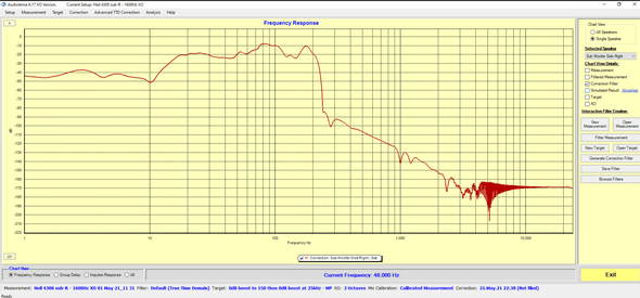

Hi @juicehifi
Maximum value on the correction filter graph below is -5.54dB
Does this mean in my convolver that I can safely apply +4dB of preamp gain and not have any clipping issues?
And is there a way to add this +4dB to the correction filter itself, so I don't need to do anything in convolver?
Why doesn't the correction filter auotmatically get closer to 0dB ? Does it deliberately avoid getting closer for technical reason?
I set my sweep level to -3dB in the measurement box - is that related at all to the below or unrelated?
Thanks!
