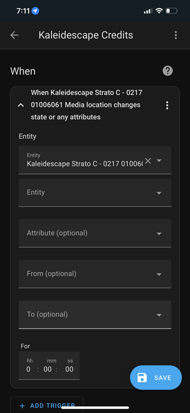

Hi Travis! I’m stuck on getting the Credits sensor set up. Is this something that can’t be done through the app? Or do I have to go into the code? Here’s where I’m stuck. There’s no drop down choices for the media location attribute.
There's another cool hidden feature you can activate to create a longer duration of the transition between states, so you can set a slow fade up of your lighting, almost unnoticeable when you're in the room.
In the automation settings, click the three buttons in the top right and select Edit in YAML.
This will bring up the code behind the script, and you'll need to add the part about the duration.
Once it's been added, you can see and adjust it in the visual editor.
Not sure why they hide this feature by default.

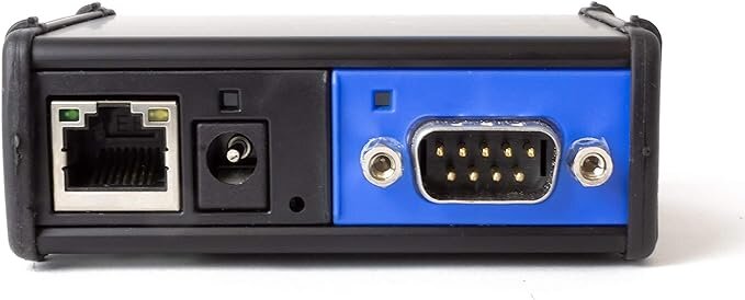

Hey Travis
Are you controling lumagen with IR?
Have you looked into serial to IP converter?
Someone AV says they used a Global Cache IP2SL Itach TCP/IP to Serial Converter to control their lumagen in HA.

I have found a Lumagen integration for HA and am using the Global Cache adapter to communicate.
What you’re seeing in that screenshot is just a connection so the Lumagen powers on/off according to the projector’s status. Then I’ve programmed the commands I need into another screen in various activities on the Unfolded Circle remote.
What Global Cache adapter are you using?
This is the one I bought.
Did you have to get remote codes from Lumagen?
This is using just IP correct not IR commands
I’m using the item linked below.
Correct, it’s using IP control. The Lumagen remote codes are of an older standard that my Unfolded Circle Remote Two could not learn, even when adding the codes provided by Lumagen. The Harmony Elite, however, did have Lumagen codes in their database that worked successfully so it may be a hardware limitation of the UCR2.
I found someone who had created a Lumagen integration for HA that controls it via the Global Cache RS232 to Ethernet converter. It is not a published integration but if you need it I can put you in touch with the owner on GitHub.
