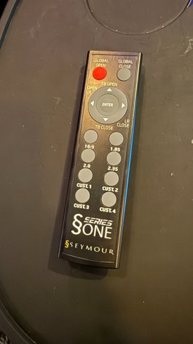

I do like the 1.85, 2.40 direct commands.
The only hiccup is the screen must slide all the way back to the home starting position first then you can hit 1.85 (i can solve this with HA automation)
