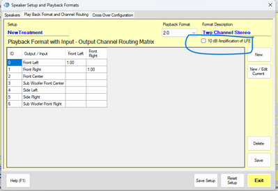

Check that 10 db Amplification of LFE is unchecked on Play Back Format and Channel Routing tab in speaker setup
Hi, thank you for the tip, this was checked. I will try another measurement on the weekend without that option!

In addition to this, there is a "amplify LFE by 10 dB" option that could potentially steal 10 dB as well. So uncheck that unless you need it.

I had 2 problems:
- the 10db boost was a problem it seems
- the subwoofer was not in LFE mode
I do now have a correction which works fine without db boost in the convolver!
Thank you for the tips!
