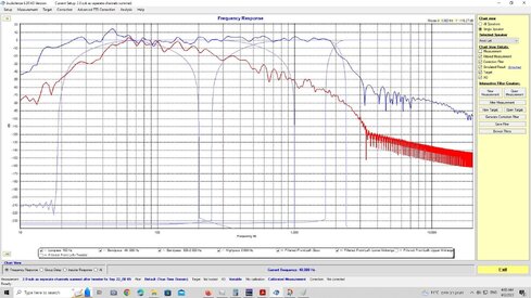

About 2 years ago I hastily (stupidly) decided to boost my low end by adding a subwoofer. I bought an OEM 18" PA subwoofer. Little did I know that PA subwoofers (no matter how big) are tuned for music bass and mid bass only. Anything below 40hz is not interesting in that respect. My mains in my 3-way three amp system the 10" woofers are in a large ported cabinet that play down to 20hz ~-5db but they just do not produce that deep base. See below.
See added screenshots: Blue - woofer, red - PA sub.

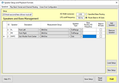

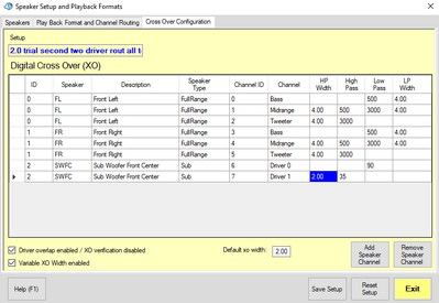

You mean something like this:
So driver 0 is the HT sub that has no HPF and a LPF of 100hz, Driver 1 has HPF of 35hz and no LPF. In the PA sub it is possible to add an LPF using the plate amp. The question is with no LPF how would AL treat the crossover/LPF that is introduced by the sub itself. Would AL try to correct that drop as there is no LPF for that driver?

Yes, exactly.
Some experimenting over that theme should give you a good result

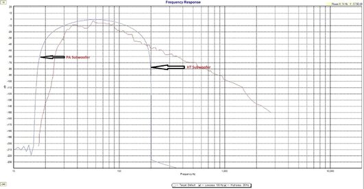

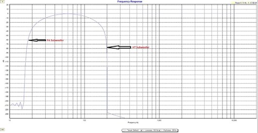

I feel like I am missing something, probably do to my ignorance in how AL works. If we look at the 2 subs configured as one sub with 2 drivers as you suggested above. The HT sub has only a LPF so it plays from 10-100hz that is fine. The PA sub (driver 1) has only a HPF so it plays from 35hz-20000(?). see below.
If I add a crossover on the PA sub itself, as I can't add one in AL, Lets say at 90hz it will probably measure like this below:
My question is: Will AL try to correct this sub because in the software it has no LPF? will the dropping signal above 90hz be boosted to fit the crossover curve for that driver that is essentially 35-20000hz?
Thanks.
