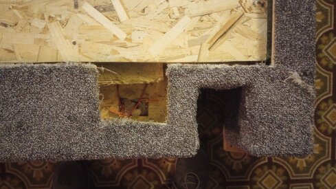

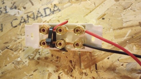

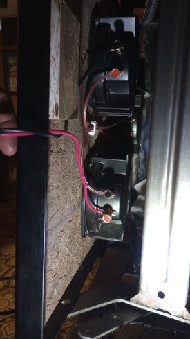

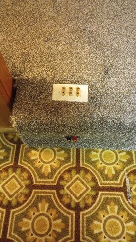

Updated pictures. I removed the shakers from the platform and installed them into the chair arms. I didn't like the effect of this. The arm shook and not much else. I then removed them from the arms and mounted a piece of plywood to the bottom of the frame. With Velcro and a couple of screws. In the process of doing this I found 3 shakers were making noise and 1 was inoperative.
It was an unwanted noise. Much like when you overheat a voice coil, and it makes a scratching noise. When I called Parts Express, he made it sound like it's somewhat common.

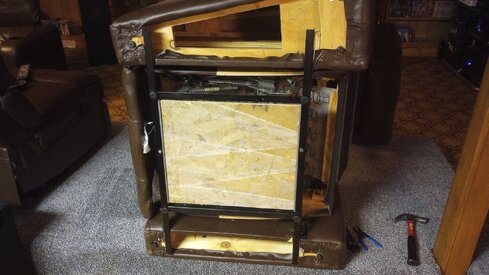

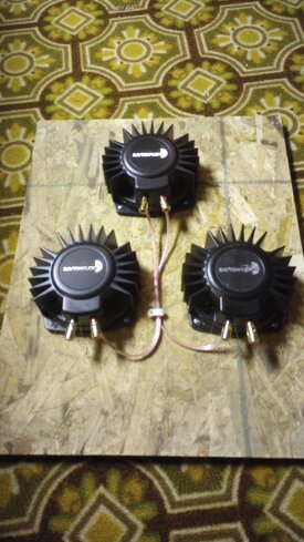

Ok, I think I have the final shaker placement done. I have 3 shakers mounted to a piece of plywood, that is then Velcroed to the frame of the chairs, I also have a couple of screws to solid mount the shaker plate to the frame of the chair. This works very well. No unwanted noises. The chairs are siting on the original platform. I then reset everything. I followed the tutorials for sub alignment and EQ using the Mini DSP 2x4HD. ( I previously made my own filters.) I couldn't believe how flat the auto EQ feature got my sub response with a room curve built in.. I then ran Audyssey. I do not understand what Audyssey is doing. It took a flat response and messed it up. Anyway things sound better, but not as good as I am remembering from the past. I am likely not remembering correctly. I am struggling with the dialog. My cheap 3 channel system upstairs is winning on the dialog front. Any suggestions of things to try would be great. New pics, and measurements included.
