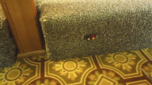

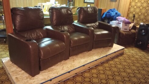

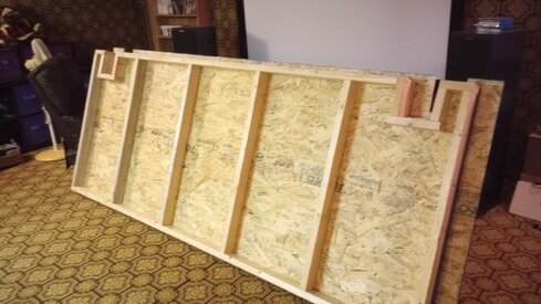

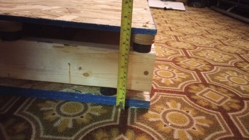

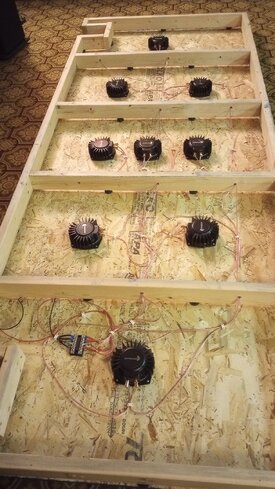

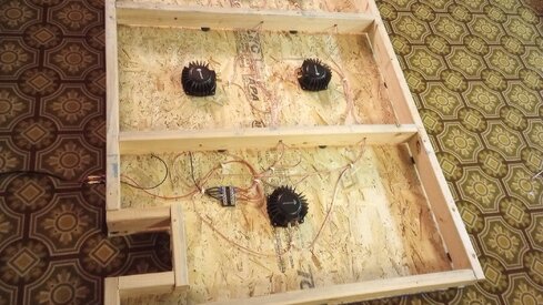

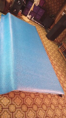

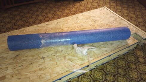

This is sort of a build thread with questions. I started an active riser project. It is 4 feet by 10 feet with 9 Dayton audio BST-1 bass shakers (tactile transducers) wired with 3, 12 ohm circuits to make the final load to the amp 4 ohms. I am powering them with the Dayton audio SPA-500 amplifier. I will need to take it apart and glue all joints as they buzz at certain frequencies. I have found with trial and error to make a filter to limit it to 50 Hz on the high side and I did 12 Hz on the low side. I really like the effect it produces. I don't need to crank up the volume to high levels to get the tactile feeling. The wife will hopefully complain less. I used rubber spacers around the perimeter of the top and bottom sheets of plywood. This was in order to decouple the subfloor to the frame. the gap on the top is .75 inch and the bottom is 1.5 inch. This is to allow air flow inside the frame. I then put R13 insulation inside the frame.
I have ben trying to find what carpet to cover it with, but am having a hard time finding much in black or dark grey. What I have found is automotive, boat carpet. I don't think it will work as it does not seem like air can pass through it. I am looking for suggestions on this. I would also like to hear from others what they would do differently if they were to build one again. I plan on using rope lighting around the perimeter. Debating on installing a 110 outlet in it.
I don't understand why, but the sound has changed in a negative way. For the most part all that has changed is that the seating position moved up 7 inches. The measurements I have taken show an average of a 6db drop across the entire spectrum. What I have noticed is the middle and high frequency's are less clear, quieter. I would like recommendations on how to correct this. I will add measurements from before and after the riser. the only DSP that has happened is time alignment and reducing a 42 Hz peak. I have no problem taking more measurements, however my understanding of the functioning of REW is pretty limited. I did have REW make a filter to put into the Mini DSP, but I didn't like the results.
Any and all suggestions, Information is welcomed.

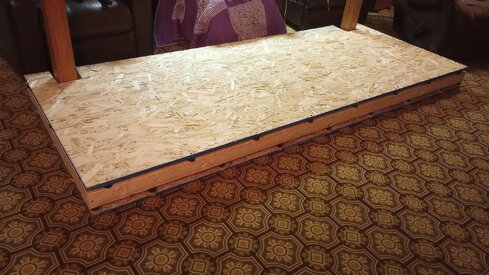

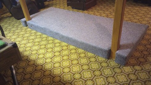

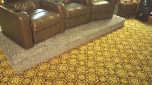

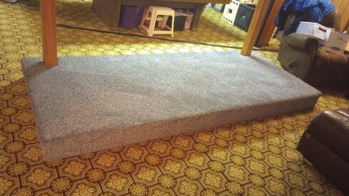

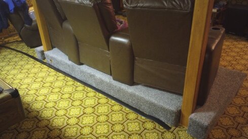

I disassembled glued and re assembled the riser this weekend. I haven't done any measurements yet. The wife wants to watch a movie. I won't say no. I built this system to enjoy it. Feels more like work at the moment.
I checked the center channel dialogue adjustment. It was on with a trim of +1. I turned it off. I then watched about 5 minutes of a TV show. I couldn't tell a difference. My center channel was the only speaker I had bi-wired, so I ran a single run to eliminate that as a possibility. I don't think it would be that as it has been setup bi-wired since 2004. Also 1 of the connections on the connection plate to the crossover inside the cabinet had vibrated loose. I tightened then soldered the connection.
I think that I will reset all settings and then run audyssey again. Not sure when that might happen. I need the wife and kid to be elsewhere.

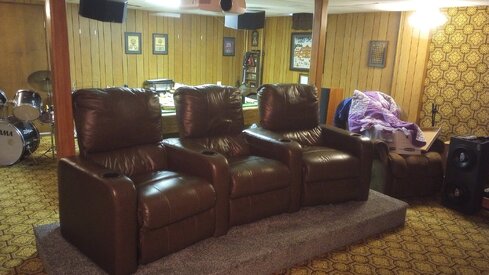

I finished the riser with the exception of finding a 30 foot piece of dimmable rope light for the perimeter. I did do a factory reset of the Marantz 7702mk2, and re ran audyssey. I also found a video from GR research
for doing a crossover modification for my Klipsch RF7 version 3. Its a rather expensive, so it will need to wait for a bit. In the video he explains that the image center is very large and that the vertical off axis is pretty terrible. He gave a tip to tip the speaker backward to help with this. I put a 3/4 spacer under the front feet for now. I haven't taken any measurements to confirm anything yet. Overall I am pleased with how the riser turned out and performs. I do wish I didn't create other problems.

New measurements with the finished shaker platform. Fronts and surrounds tilted back with 3/4 inch spacers I also boosted the subs PEQ at 20hz a little. No other changes. First 1 is platform on, second is platform off. Audyssey is on for all of it.
Still sounds as if I am listening with cotton stuffed in my ears.
When doing the test tones for room correction or REW sweeps in the surround channels I can hear the heat ducts humming after the tone is done. I don't remember hearing this before the riser.
The platform on is producing a bit more distortion between 32 and 46 Hz, but otherwise platform on now looks pretty much the same as platform off, so that's good.

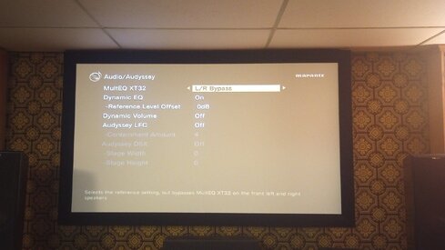

I played with this for quite some time. I turned the subs off through the Marantz, and ran he fronts in full range. If I have the Audyssey MultiEQ set to L/R bypass it sounds best. As I remember it used to be. I expected the Audyssey off setting to sound the same as bypass, but it is not at all the same. The MultiEQ reference setting is by far the worst at this time. Listening to music like this is good. I have yet to try a movie or tv show. I would prefer to have the subs active. Pre riser measurement included has the sub off, and audyssey off.
