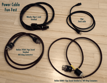

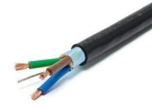

I finally settled on testing four power cords of the same length (two meters - 6’6”)

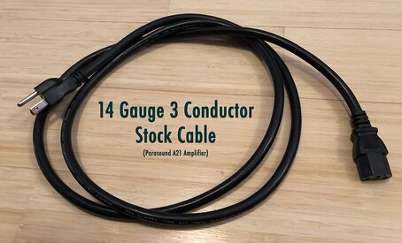

1. Stock power cord from my new Parasound A21 power amp – 14 gauge - 3 conductor - No shielding – Molded construction
2. WAudio “Audiophile Quality” power cord – 10 GA – 3 Cond – Shielded – discrete components (covered in TechFlex so no idea who makes the wire)
3. Homebrew #1 “Audiophile” power cord – Belden 83803 – 12 GA – 3 cond – shielded – AweKing 20 amp male and Hi-Fi King 15 amp IEC connectors
4. Homebrew #2 “Audiophile” power cord – Belden 19364 – 14 GA – 3 cond – shielded – HiFi King 15 amp connectors

Stock Cable – Parasound 14 Ga, 3 cond – Molded plugs

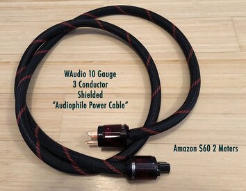

WAudio Hi-End Hifi Audio AC Power Cable Power Cord US Plug - 6.5FT (2M)
Amazon $59.99
https://www.amazon.com/gp/product/B01L2UNMXI/ref=ppx_yo_dt_b_asin_title_o06__o00_s00?ie=UTF8&psc=1
My first order of business was to check the construction of the WAudio “Audiophile Power Cable”.
First inspection of the cable revealed no overt problems or issues. Build quality looked good and cosmetically it looked very nice. It is a full ¾ inch thick and covered in TechFlex. I took apart the plugs on both ends to determine build quality and found the connectors to appear sound and well built. The wiring was clean with no stray strands floating about. The shield was properly connected with the ground wire to the ground pin on the male plug side (supply/wall) only. The wire brand was unidentifiable because of the TechFlex covering but was certainly 10 Gauge and shielded. No idea of the quality of the shielding could be determined by inspection other than it is a braided shield construction (so 60-85% is likely the shield coverage). There was no evidence of a foil shield that I could see. The connectors appeared robust and well-made and were branded WAudio. All-in-all a pretty cable for $60…

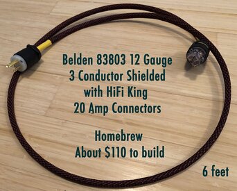

“Homebrew" #1 Cable – Cost to make approx. - $118.00

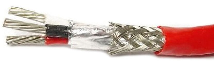

1. Belden 83803 12 GA – 3 Cond Shielded – Parts Express - $12.90 per foot
2. Hi-Fi King CC-18 IEC Plug 15A/125VAC – Amazon - $12.00 ea
3. Aweking 5-20P Male Connector 20 Amp 125VAC – Amazon - $20.00 (Hubbell would also be an excellent choice)
4. TechFlex - ½” expandable covering – 25 feet - Amazon - $8.00 (or 32 cents per foot)
The Belden 83803 is considered a high end instrument power cable. The conductors are 12 gauge (7x20) stranded. It is 100% Beldfoil shielded with an overlaid 85% tinned copper braid shield and a separate drain wire. Teflon insulation inside and out. Low capacitance and very low resistance (1.7 ohms per 1000 feet!) make this a near ideal power wire.
Because of the heavy gauge it is somewhat inflexible and stiff but not overly so.

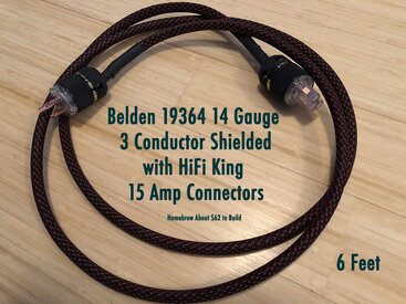

"Homebrew" #2 Cable - Cost to make approx. - $48.00
1. Belden 19364 14 GA – 3 Cond Shielded – Wire and Cable Your Way - $3.33 per foot (20 foot Minimum Purchase)
2. Hi-Fi King CC-18 IEC Plug Female 15A/125VAC – Amazon - $12.00ea
3. Hi-Fi King PU-18 Plug IEC Male 15A/125VAC – Amazon - $12.00ea
Belden 19364 is also considered a very high end cable in the instrumentation field for AC power applications. It is a 14 gauge 3 cond stranded (7x28) cable. It is 100% shielded with a foil shield and sperate drain wire. The thick PVC jacket make it thicker than the heavier gauge Belden 83803 cable. But even though thicker it is somewhat more flexible than the 83803.
Note: The Belden 19364 has long been appreciated as an “Audiophile Power Cable” in Europe.
With my “Homebrew” cables I was confident in my DYI skills and the build quality. In building the cables I did use a layer of shrink tubing over the TechFlex at each connector to provide a better strain relief and to cover the ends of the TechFlex which can fray after cutting. I made sure to ground the shield(s) at the supply side only to provide the proper noise “drain”.
