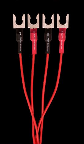

I use Anti Cable Doubles 12 gauge speaker wire which results in an effective gauge of 9.
