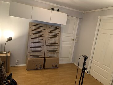

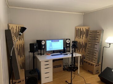

I have just moved into a new place and purchased Vicoustic super bass extreme bass traps. 6 of them 3 on each side.
The room is 3 x 3.6 x 2.4 meters. Desk is on the 3 meter wall.
Listening position is at 38% from the front wall. Amphion One15 speakers equilateral triangle to the mixing spot at 1.05 meters. Also 4 absorbers in the room 1 on each side of first and second reflection points and 2 on the back wall side by side.

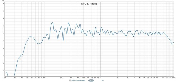

I am waiting for a new desk so things are a bit temporary. But from my measurements I think the bass traps are not doing anything at all.
Would you take a look at my REW file attached?

Based on your REW data, I'm seeing some drop around 100 Hz., but nothing of any value. It also looks like you could use some help at 50Hz., but the devices do nothing. You might look into using Helmhlotz resonators tuned to those frequencies. These are easy to build, if you have basic wood working tools and skills. You could also use some absorption at the higher frequencies, and definitely some diffusion. Lastly, that dip in the LF at around 85 Hz. is likely caused by vibrating wall panels, if they're drywall.

You posted the same rhetoric elsewhere. As was pointed out there, REW shows that your room has very little LF modal action. But whatever modes are at play are buried down at lower levels as a result of the weak LF from your speakers.
The modes can be revealed by adjusting REW extents. Then we see that they are well mitigated by those Vicoustics. Perhaps you are a sore winner? ;-)

You are right, on the walls. They are very light walls. Almost every wall is a plaster wall on a wooden structure, old-school housing.
I also have driven the room with a different pair of speakers with a sub (Neumann KH120s with KH750 sub) and the results weren't any better. I still had that crazy dip at 80 Hz. I don't agree with you that it's just the speakers. But i am not disagreeing that they aren't as low-end beasts as one might expect. But that's not the game I am after really, I am not an EDM producer :) I just need equal response from my upper bass - lower mids zones. Which is what makes or breaks a mix anyway :)
And of course, I didn't build this room this way. I just ended up in it :) And I agree that it sounds / measures nothing like any other room i have ever worked in.
P.S. As you have suggested earlier, I am still waiting for the desk to arrive to experiment further with speaker positioning. I will report after the desk :)

This is by far one of the strangest measurements of an existing room I have seen. There seems to be almost modal influence of the room.
Regarding you question of the vicoustic absorber. If you look at the RT60 values... It does exactly what its supposed to do. But, you do not bass traps. You need some midrange absorption and some high frequency scattering.

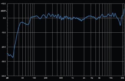

The 80 Hz dip is in the loudspeaker. A from your measurement. B is from Amphion Web site. From 20 Hz to 100 Hz frequency response from JPEG A and B have a close match.
Best improvement for that room would be to get rid of the plaster walls and replace them with something softer. Hard surfaces are a bane of audio reproduction. There seems to be delayed energy at 50hz and 100hz which would indicate a modal problem. A couple of helmholtz resonators could help the situation. But as others said, your biggest problem is lack of bottom end extension at the moment.
