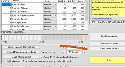

In a new experiment, I have connected my Okto dac8pro MCH DAC directly to my power amps, bypassing my Marantz AV-8802A preamp entirely. For playback, I use HQP through Roon for volume control and it works fine. Greater transparency, for sure, but I definitely need to re-run my AL measurements as it sounds quite different.
My concern, of course, is that with Roon and HQP bypassed for AL measurement, the AL sweeps will be a full amp volume level and could well destroy my speakers. Is there an output volume control in AL that I am unaware of (as I have previously adjusted the system volume for measurement using the Marantz preamp), or another workaround any of you may have used or can suggest?
Thanks, all. JCR
Unless I am missing something would you not adjust the gain setting when you create the measurement to regulate the volume? This is how it works for me using the XO version. Marked in orange in the pic.
Yes, I thought that merely adjusted the microphone sensitivity, but you are correct that it actually controls the output volume level of the sweeps. Thanks. JCR
