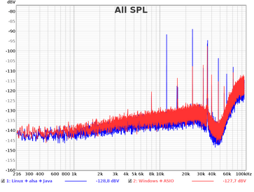

No Windows (because of the driver hell...), sorry. I use Linux, the driver here is a class driver that works perfect with my asus Xonar U7. I don't know what's wrong with that UMC202HD, also noise figure is by far worse than i would expect from a 24 bit ADC. I suspect these MIDAS preamps are crab. The distortion increases with input level, is never below 0.05% and reaches 4% before clipping. That's probably why the manufacturer gives no technical data at all. I will return it.
Thanks for the hint to ASIO. I managed to get 24bit/192khz with flexASIO driver type WDM-KS. The result is still different. I tested the same hardware (Xonar U7) on linux and Win10 and noticed that there are some disturbing phantom signals, but they are at different frequencies under windows and linux. As it is identical hardware it cannot be just hardware related, i think. It must be related to some programming detail in the drivers, some buffer size or so. I wish someone could recommend me a better soundcard that just works....
