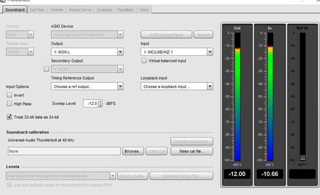

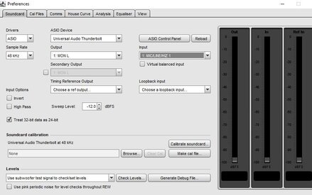

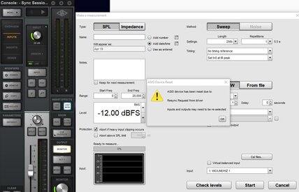

This is my next attempt at REW. Unfortunately, another failure.

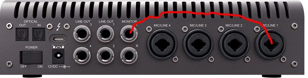

At first I thought that the output and input connection was wrong, due to the connection via the subwoofer. Now I disconnected the sub and used only one cable to connect out to in. Everything goes fine until the soundcard is calibrated. After setting the level to around -11.53dB and pressing next x2 I get an error message: "ASIO device has been rest due to Request from driver..."
I have attached pictures of my individual steps. Also the method of connection (only power cable, Thunderbolt cable and audio (in red) is connected). Has anyone encountered a similar problem? Any advice please?
