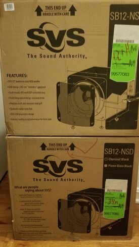

I have these sitting, waiting to anchor a two channel system someday.

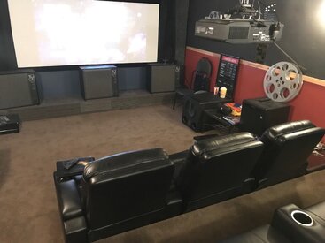

Oh I knew I was jumping on this thread lol! I have dual PB 4000's running them near field behind my couches in all out 3 port open standard mode!
And its fraggin awesome fellas!
