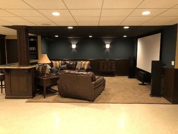

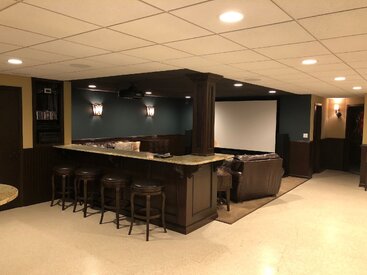

Well after I tell you the size you'll say I need 4 Cap 4000s!
My space is roughly 2,560cu ft (20x16x8) with 2 walls opening to an additional 25,950 cu ft. Total basement area including theater is approx 28,500 total cu ft. (66x54x8). I've attached a couple pics that show the openings.
First off, @jdubs75, that is a beautiful space! Looks well thought out (judging from paint color on walls/ceiling. You need to create a showcase page (click here and click create showcase in upper right corner: https://www.avnirvana.com/showcase/)! ;-) I'm sure others would enjoy looking at it!
Secondly, you definitely have a massive space to fill. The right sub will give you some good near field impact and output... I think you're barking up the right tree by looking at JTR. Perhaps Seaton Sound would be another good potential brand. Of course, that V3601 (PSA) is also a beast.
As Todd already noted, you are looking at the right brands. You may find that your proximity to these subs is sufficient to get a lot of visceral impact from the bass. If not, I will bet it has more to do with the floor/subfloor construction than a lack of room pressurization. The reality is that standard drywall construction provides little acoustical blockage of LF sound, which means very little is being reflected or contained in the space. While your space IS more open than most, at very low frequencies it really is not so bad.
Both Jeff and Mark are great and knowledgeable guys, I highly recommend either company. For a given single subwoofer, I believe the JTR's will generally be the loudest. The sealed nature of the Seaton sound subs will make them louder to lower frequencies and are great for getting down into the single digits if that's your thing.
Your room looks beautiful, great job!
