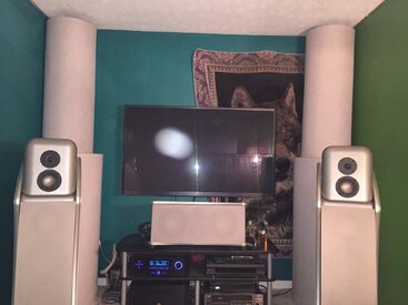

Excellent direction @JStewart. Tail-chasing has drained my energy. And yes, I was referring to the Revels in the Green Room—too naive at the time to paint it, but the new room will inherit a color suitable to a dedicated theater. The Revels are ridiculously oversized for that 9x13ft space. They’re too close to the sidewalls (Toe’d In 8” from wall at rear corner; 15” at front corner), and to each other (5.5ft on center). Like @Sonnie mentioned, difficult to coax decent 2-channel sound out of that configuration.
So following your lead, I’ll draw up plans as accurately as possible at this point. It seems setting up on the short wall will be riddled with hurdles and still not deliver HT wow-factor. But those are he cards I’ve been dealt (unless I can convince the missus otherwise). For now, it’s back to the drawing board!
The resultant sketches surprised me--pleasantly so for the short wall setup; not so pleasantly for the long wall. If you look at the sketches I attached to the FLOOR PLANS & VIEWS section (Post #2), you'll notice that I was able to shoe horn in a 100" diag screen! I had previously bellyached about not having enough room width, but lo and behold, I wasn't wrong just once, but twice! My current room is 9x13, not 10x13 as previously reported; so the new room coughs up an extra foot per side. @JStewart, a pic of the current layout in the Green Room is attached to this post. Bottom line is that a 100+ inch diagonal screen fits with room to spare when setup along the short wall. Long wall setup increases that size to 110" diagonal.
My take on the short-wall layout:
  • Optimizes multi-channel A/V entertainment
  • Accommodates reasonably high fidelity stereo playback
  • Allows upgrade to 7.1 from 5.1
  • Restricts subwoofer placement (unless one or more 2nd-row seats are removed)
My take on the long-wall layout:
  • May not optimize 2-channel stereo listening
  • Accommodates big-screen experience for MLP
  • Theater experince deteriorates for non-MLP seats
  • Retains 5.1 system with compromised surround locations
  • Allows for subwoofer placement options.
? Thoughts ?
Oh man, I feel so bad to say this, but the screen width for a 100" screen in 16:9 format is 87". Add a few more inches for the screen border.
Room Width 132" - 90" = 42", so 21" on either side of the screen.
The long wall sketch looks more promising. For this scenario if you want to keep the speakers in the same position I'd look what happens with a 92" (80" wide without a border) screen and moving it closer to the L/R speakers front baffle plane so that the speakers won't block the view of the outside seats and maybe adding a little toe-in to the outside seats. At 7 to 8 ft viewing distance a 92" screen will appear quite large as it would be closer than THX ideal. A possible downside here is it would fall intot he range where more pixels might help. The other interesting thing to consider with this scenario is a 75" flat panel has a THX viewing distance of 8.5 feet, that should be a strong contender too for this scenario.

...I'd opt for a ceiling mount pull down acoustically transparent screen. Bigger will be better for the screen and give you a "theater" experience and you could at least place the Revels further from the sidewalls for your two channel it that helps.
Given that the short-wall scenario screams for a drop-down AT screen, and that the long-wall scenario would benefit from one located on the plane between speaker baffles, it seems logical to go down that road. Think I’ll reconsider some options and see what develops.

If two channel music is more important... there would no question for me using the long wall. If movies and surround are more important... I probably lean towards using the narrow wall.

Secondarily, how important are the number of seats? I'm guessing more times than not that a solid row of five is less important?

Music is more important. I know what the Revels are capable of, and it pains me to stuff them in locations which severely compromise their audio magic. SQ is so mediocre with such constrained stage width and barely palpable image definition that I’ve curtailed my listening habits to the point they’re practically nonexistent.

The room will need minimum of four seats. I’m somewhat of an antisocial recluse, so don’t anticipate any bigger audiences. I will be the only participant the vast majority of the time (4 hours/day). My wife will keep me company 1-2 hours/day. Finally, the mother- and sister-in-law will join us maybe once a week—they have no concept of high fidelity sound and are basically indifferent to picture quality, so they probably won’t mind sitting far off-center or more in front of one speaker than another—they’ll be there for the company.
As for the occasional visitor who also happens to be an A/V enthusiast, I’ll give up the MLP. I’m not going to stress about smoothing bass across all seats, though it would be professional and courteous to remove line-of-sight obstacles from the design.
