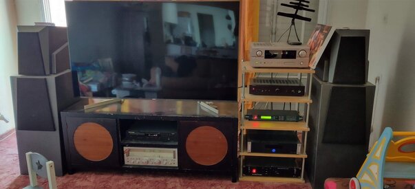

I have upgraded to the MiniDsp 4x10hd. Did a few measurements of each driver at 1 meter and added the PEQ to the output channel. That worked great. The response at the woofers that are crossed at 500hz was improved. When I measure at the listening position I see a significant drop in the area under 100hz that I don't see at the measurement at 1m. The listening position is 4m from the speaker. Attached are pictures from the right speaker. What could be the cause of such a dramatic drop? How could I solve this?

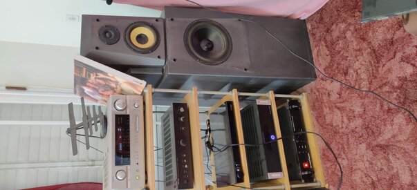

Hi Dan,
Thanks for your help. This is a 3 way speaker. The woofers are very heavy and the mid twitter is on top of them. Woofer+mid twitter weighs about 90kg. How do I go about using Pink noise and RTA/spectrum?
