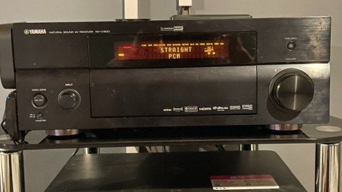

I have added Bluetooth capability and internet streaming capability to the old Yamaha RX-V1800 by the two deviced attached to the AVR, The top device is the bluetooth to audio out converter and below that, a ROKU stick as shown below.
