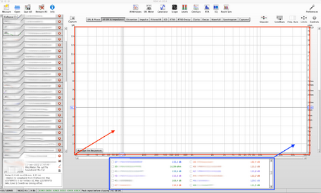

on Mac, even with the option "Collapse" active the legend doesn't take all the space:

So I was thinking of an option to resize the size of the legend by "borrowing" the size of the graph window, perhaps by dragging a corner, in order to be able to read more easily what is in the legend:

7,314
The width of the legend is determined by the width of the graph and the length of each trace entry. In your first example there isn't enough width to put 4 traces on a line, so there are 3 traces per line. In the second example there isn't enough width for 3 traces per line so there are 2. The early access build allows the legend to use a bigger proportion of the height, to reduce scrolling, but that won't have any effect on the width.
