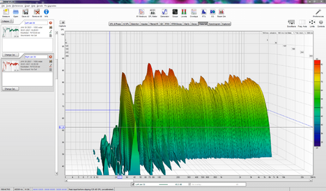

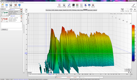

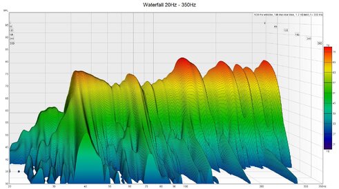

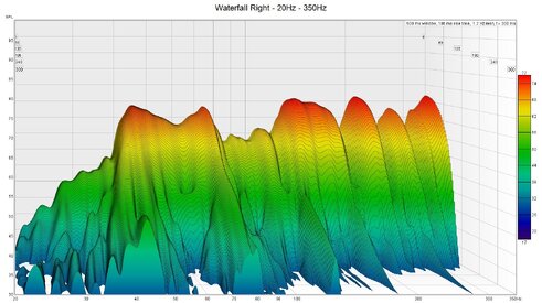

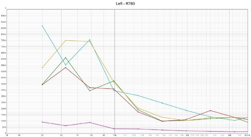

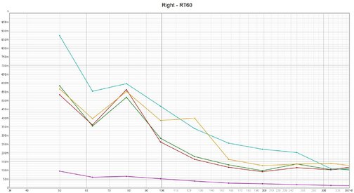

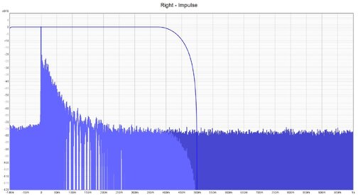

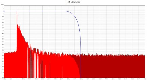

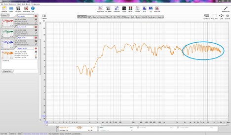

I can't say much, but there's definitely a high-frequency problem. From 4.6 kHz and up. Maybe it's a feature of the tweeter. It looks as if the tweeter was poorly fixed. Waterfall is almost perfect.
@sm52 First off I want to thank you for chiming in. I appreciate it very much. My Focals were purchased in May 2019 and have not been repaired as far as I know. I am wondering if the high frequency issue that you speak about could be inherent to this particular model. Is this something that you saw in both left and right measurements? And, which one of the measurements revealed the HF issue
It seems to me that such an amplitude at HF should not be. Should be 3-4 times less. On the Spectrogram graph of right side, you can see where the reflection is about 45 cm from the speaker. The reason I cannot understand. You need to change the measurement location and then compare this HF area. And try another manufacturer's tweeter. Then something will clear up. If you want to understand. But maybe the sound suits you and you don't need to do anything.

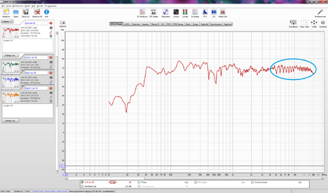

Thanks again for taking the time to assist me. I will verify the settings at each cabinet. I will also redo the measurements.

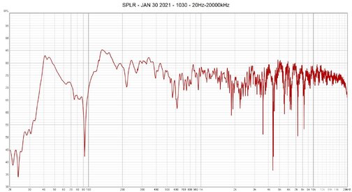

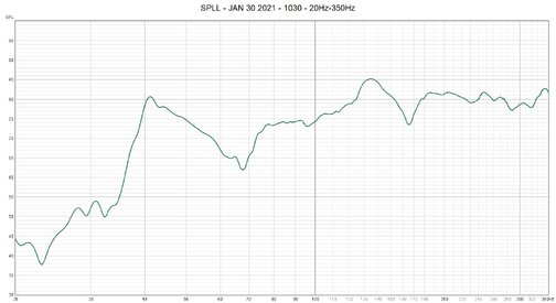

@sm52 Good day. I was wondering if you would be kind enough to look over my latest measurement. Please let me know if you spot any anomalies I took my near field monitors off of the IsoAcoustic stands that I had them sitting on. Thank you in advance. Your time and assistance is greatly appreciated. Peter
38839
38840
38844
38846
38831
38832
38833
38834
38835
38836
38843
  • JAN 30 2021 - 1030.mdat

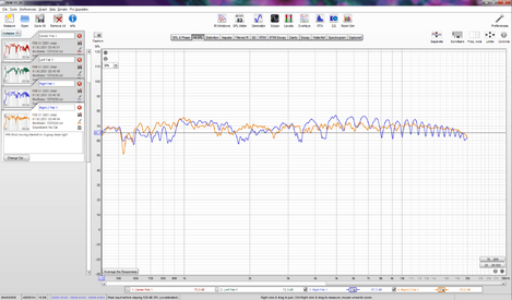

I watched. Quickly I cannot say something for sure. Need to think. So far it is clear that the stands spoiled the upper range. But without them, the lower range could get worse. How did the sound change when the stands were removed? I think the 4 kHz to 8 kHz rattle is from the mixer controls. Instead of coasters, try putting a sheet of rubber 1-2 cm, then 5-8 cm of concrete in the shape of the bottom of the acoustics, then again a sheet of rubber 1-2 cm.

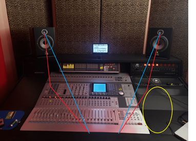

When placed directly on the desk I found that the tweeters were firing clear over my head. It is a little primitive but I use a Bosch laser level that I have. To be honest I did not hear much of a difference in the low end. Then again, I have only started using the speakers and the room about two weeks ago. So, this is a brand new experience and obviously need many more hours in the room before I know what is wrong or right. And, then there is the ever present reality that my hearing has changed with age. I have now put the the speakers back on the stands. At least they are angled down toward the sweet spot. You are probably right about the impact that the large Argosy console must be having on the way sound be reflected / diffused. Unfortunately, this is the only room that I have to work with. I'm afraid that I have to make the best of the space that I am in. It is all that I have to work with at the moment. Thank you again for reading and responding to my post. Immensely appreciated. Peter
When you removed the IsoAcoustic stands, the HFs are better. Waterfall was almost perfect, but it got worse. Therefore, you must try to use other stands, best of all as I described. The slab can be concrete or marble. Rubber top and bottom. Plus on the right side of the Argosy console, where the flat surface, the sound absorber should glued.
@sm52 Are you referring to the red absorber or the one behind the speaker with the leopard pattern?
In yellow, I painted a place where you can glue the sound absorber. Blue is a direct beam of sound from tweeters. Red - reflections. The length of the sound beam through the reflection is + 45 cm. You need to take a tape measure, measure the distance from the ears to any tweeter, add 45 cm, bend the tape as shown in the reflection in red. Where it touches the surface there will be a place of reflection that causes the sound to shake from 4 kHz to 8 kHz. I suspect the knobs of the sliders.
I took another look at your last measurements in post # 11. They are better in all respects. So it is best not to use IsoAcoustic stands. There is a reflection at 40 Hz.
@sm52 Good morning. Now that you point out that large bare area on the desk I can see how that can result in some undesirable reflections. I just want to be clear. Are you suggesting that the speaker remain flat on the desk provided I use some form of decoupling mechanism. Should I not be concerned that the tweeter appear to shoot straight above my head. Or, is that not an issue.
Thank you for taking the time to assist me. It means a lot to me. Much appreciated. Peter
Your Focals stays where it is. To prevent the tweeter to shoot above the head, place something under the rear legs. With a yellow oval, I marked a place on the table, because of which there may be a reflection that distorts the main signal. For better bass performance, the Focals stand should weigh 2 or more times the Focals.

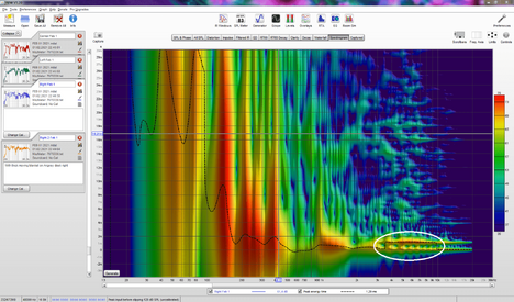

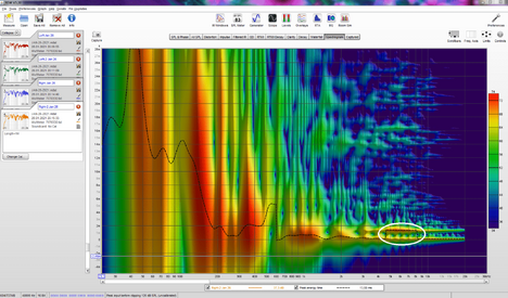

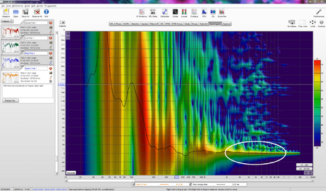

@sm52 I took your advice and tried a little test today. I took a very thick moving blanket and placed it where you had placed the yellow circle in the photo. What do you think of the new result?
Congratulations. We found a pest. The Right-2 graph is excellent.

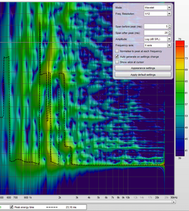

Glad to hear. But we still talked by looking at graphs and measurements. How does the sound change by ear? Compare the sound now and if the Focals are on IsoAcoustic stands and there is no absorber on the right.
@sm52 Believe it or not I took the measurement with the thick blanket in place but never sat down to listen the effect when playing music through the speakers. I will do that tomorrow.
Note: Can you tell me what limit setting you used to achieve the Spectrogram images that you attached in your last post. Thank you.
