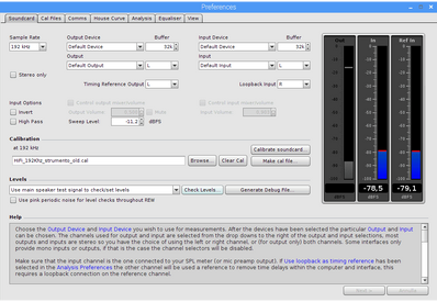

Good evening,

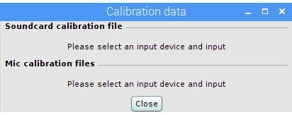

I noticed that the generated calibration file is associated with the selection of the sound card through the device name. I use a raspberry and the name of the device selected normally is default device but since it does not correspond to any audio devive no calibration file is associated. Would it be possible to have a calibration file automatically associated for the default device?

That wouldn't be a good idea. The default device can change without REW being able to tell, so it could end up using an incorrect cal file. That is why the cal file is linked to the device name. Why not just select the audio device name?
Because on rasbian even selecting the device name on input and output then Defaul device appears in the menu and for each measurement it is necessary to set the sound card calibration file. This is very impractical ....
That must be a Raspbian 'feature' then, haven't seen behaviour like that on Windows or macOS. If the card is removed while REW is running and so disappears from the list of available devices, or if the card refuses to provide audio lines, the selection would revert to Default device but beyond that REW selects and uses the named devices that had previously been selected.
Are you sure it also works correctly on PCs with Linux installed? In my opinion the defaut device is a feature that is of all linux systems and since REW very well pretends on this operating system it would be necessary to find a solution to this problem.
Thanks anyway ...
Default device is offered as an option to select when using Java drivers on any supported OS. The soundcard cal files are linked to specific devices, not Default, so a device selection needs to be made to use them.
In fact the selection of the device works on linux, I tried on a PC with an external SB HD Usb sound card and selecting the HD output device and input (plughd 2.0) remains correctly set. At this point I think it's a problem that only occurs on the Raspberry with Raspbian OS. To overcome this problem, perhaps, it would be useful to implement a flag on the preference sound card panel to disable the management of calibration files linked with the device name. It would be very useful for me and I would avoid having to set the file on every measure.

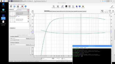

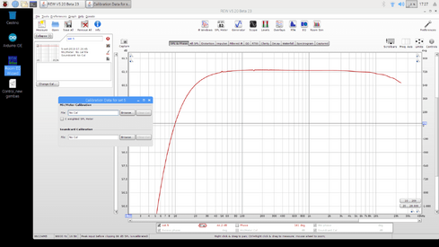

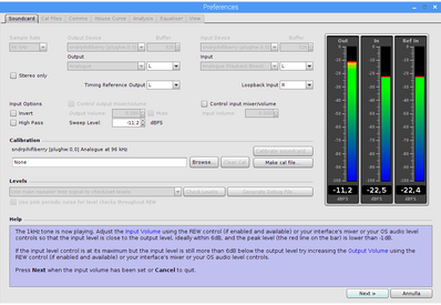

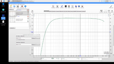

Good evening Mr. John, I wanted to thank you for solving the problem. I send you the debug file as requested
together with the screens made before starting the calibration and the second one to verify the correct association
of the audio device with the calibration file and finally after performing the REW restart.

After performing the REW restart the device shown in the preference setup returns to being
Default device does not remain as set sndrpihifiberry (plughw0,0) and does not associate
the correct calibration file.
Thank you

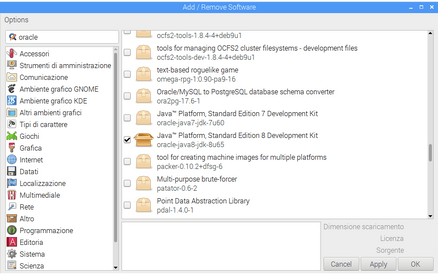

The version is Oracle 1.8.0_65, it is the one installed by default on Raspbian.
Yes, looks the same. I sent you a link to a test build earlier today, via the 'Conversations' system - the Envelope icon by your username in the forum top banner.

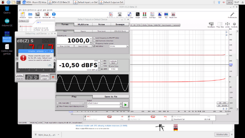

John, I wanted to tell you that REW with the default audio device does not allow SPL level calibration.
After fixing the lack of association of the calibration file, could you also correct the SPL calibration?
I know that you don't recommend using Default as an input and output device, but on the Raspberry,
inexplicably, set it this way, while with a Linux PC it works regularly.
I forgot to tell you that I tried with the version of REW 5.20 beta 25 but I think that even with the previous one it didn't work, only that I had not tried to carry out the level calibration.
OK, I've done that for the next build. It was intentional, like the lack of soundcard cal support for the default output, but I have removed the restriction to get around the problems with the Pi.
