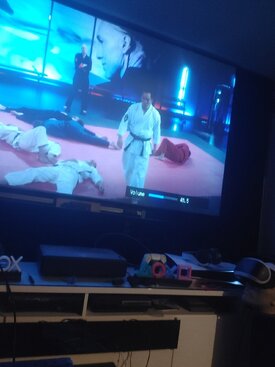

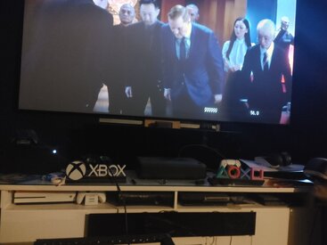

Well unfortunately my receiver has issues:
As even going with the above cables I am still having issues. No signal input issue has seized however I have lost sound processing .
I have yet to be able to get ahold of Onkyo.
I know when the issue will occur as I loose osd overlay so the next power cycle will cause no sound unless I unplug the unit.
Edit:
I turned off osd and see if its incompatibility issues with my projector
Edit:

I'm sorry to hear you're having issues. I've been down this same road with this receiver, I feel your pain.
I know this may sound like a silly question, and I don't mean to insult your intelligence, but are the new HDMI cables connected in the correct direction? They are active, so will only work in one direction. Lastly, my first RZ50 would lose OSD also. I didn't lose audio, just black screens and massive handshake issues. I was fortunate enough to be under the exchange policy of where I purchased the RZ50 and received a new unit.
You could try using one of the included HDMI/USB power adapters that came with the RUIPRO HDMI on the Cable Matters HDMI. You shouldn't need them on the shorter RUIPRO cables.
Lastly, try changing the HDMI OUT to Main + Sub. (Shortcut button located on the remote at the top, in between Power and Sleep) My first receiver would work if I did that.
No worries I chuckled but am aware of the cables being directional ( all 3 ) the response time has greatly improved from certified 2.1 to cert fibre optic 2.1 . The old me would say an hdmi cable is just a cable but having bought multiple I am now a firm believer some are better than others.
main + sub is my default ( my setup is same zone ) TV lowers when not in use . So it is the one that made the most logical sense.
Dolby Vision is dedicated to sub as it's the display that supports it.
Definitely be sure your cables are oriented correctly. Also, when it comes to 2.1 cables, make sure you're buying cables that are Ultra Certified with an actual working (scannable) certified label on the package.
