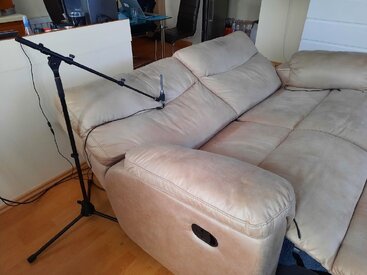

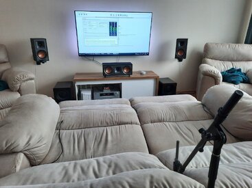

I'm still waiting for my RZ50 order to ship from AvScience. I just purchased a umik 1 while I wait.
Should the mic stand be placed behind the couch with mic boom extended out forward to listening position? I've seen some pics of new RZ50 owners using a mic stand between the mic and speakers and wondered if sound would bounce/reflect off the stand interfering with measurements.

I doubt it would have much of an effect - at least that you'll hear. My mic stand doesn't have an arm that's long enough to remain solely behind the seating, but come to think of it, even it did the stand will still "technically" reflect sound, right? c

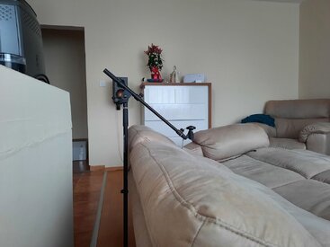

I guess with all the wave guide, room refraction, room dressing arguments one would think the boom arm and stand would do the same.
I was planning on buying a cheap $20 stand with a boom arm for the umik1 but if the small stand sitting on some boxes on the couch does just as good then I won't bother.

You might very well be right... it's impossible to completely remove any potential disturbances. If you have the means of minimizing them, though, why not? Perhaps @John Mulcahy has an opinion about this...

I'd definitely buy a cheap, but well adjustable mic stand, helped me a lot with measuing my current system (RZ730 + miniDSP 2x4) in varios positions.

That looks very similar to what I have... my issue is the extension arm isn't long enough to reach the front edge of my seats. what I need is an arm that's capable of extending.
