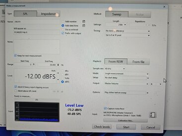

On the REW measurement page, R speaker, when I click Check Levels, I get "Level Low, -73.2 dBFS, and 48 dB SPL." See screen shot.
When I do a sweep it starts with a little popping and then continues a good sweep. Starts of saying 99db Headroom and goes down to 25.4 dB as the sweep finishes up.

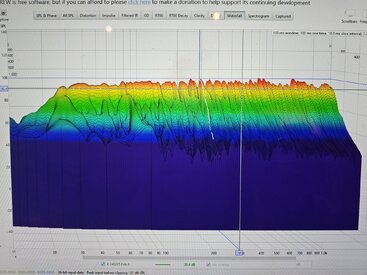

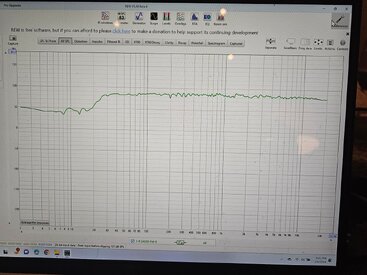

Here is the SPL graph and Waterfall. I also included the measurement file. What settings may still be wrong? Any other comments for this beginner?

The silence when checking levels for the R channel is odd, perhaps something along the replay chain is muting when there is no signal on the left channel.
For your graphs (including waterfall) set the SPL range to 105 dB at the top and 45 dB at the bottom, you can do that by clicking the Limits button at the top right of the graph and entering the values there.
