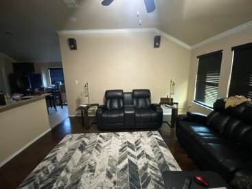

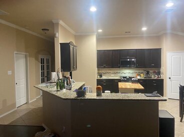

Hello fairly new to home audio I bought 2 svs PB 2000 I was thinking doing the Room eq. Here’s my question my home theater is my living room with an open floor plan would room correction help?

In most cases room EQ will help, especially in the low frequency range. Your Denon will have Audyssey that you can use, and REW will help you see what it is doing if you want to learn more about your room. REW can also help you properly locate subs prior to EQ if you have placement options.
Congrats on your purchase! Those are great subs... plenty of great bass is on your way!
Set up is going to be key, starting with placement. As Sonnie eluded, you can download Room EQ Wizard and use that as a tool to figure out placement. The software has a room simulator that you can use to get an idea of what might work... then you'll need to take things to the real world.
Your Denon's Audyssey is going to do a decent job at EQ, but the impact will be primarily limited to your seating area. Two subs was the right way to go, as that will help even out the response, but EQ is probably going to end up being your friend.
I hope you ask lots of questions and bring us along on your journey!

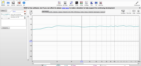

I ran the Room EQ Wizard, trying to get my subs to sound better. I put the mic at the ear level listening position. I set the generator for pink periodic noise and used the SPL meter. I raised the volume to reach around 75db for the speaker cal. I set both subs to -30db for the volume so when i did the sub cal it was around 79db and here are my results. I know I'm probably not setting something up correctly, it just doesn't look right. let me know what you think. Thank You

It would be better to upload your .mdat file for the measurements... then we can show you the correct settings to present your graphs. :T
You should put the limits on REW from 20 Hz - 20 kHz and 40 db to 105 db (pres limits knob on the left). You should also pres knob AllSPL

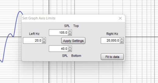

You are talking about these settings?
You are measuring the subs only... assuming these are combined. If this is NOT with the mains, then you wouldn't worry about anything over 80Hz (or wherever your xover setting is). I would also measure with the mains to see how they integrate and what the room is doing to the overall response.
For the measurements you have done, below are probably the best settings to view the response. This looks pretty good

Honestly I never thought about doing just 3-4 measurements. I will try it, this is the only seats that get used and we rarely have people over with no kids. I know i need to try 1 things at a time, but i'll ask anyway. I upgraded the subs which sound a lot better than my previous ones. One reason I picked these was the ability to change the EQ on the subs and that was the reason I bought the umik as well. Assuming the best bass I can get is without changing the EQ and even if I can get better bass. In your experience do you think I could get better sounding bass from buying a mini DSP? I know each system is different as well as the room.

Purely preference for me, but I do like Dirac Live better than Audyssey, HOWEVER... I have not used Audyssey in a LONG time, so I'm not as familiar with what they are doing with it now. You can get Dirac in the miniDSP and you'd have a lot of extra PEQ filters and shelf filters available. However again... I'm not sure you need the PEQ filters, as you raw sub response looks pretty good... assuming that first graph I posted is your subs combined with no EQ.
If you mean no EQ as in no Audyssey, then no.
Correct... no EQ whatsoever... we need to see the subs combined with no filtering of any kind.
