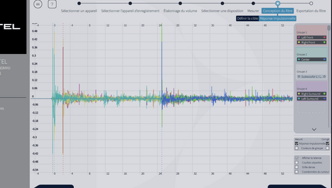

And seeing the impulses measured by Dirac (which passthrough all delays and trim in the unit) it seems tobe a bug in the AVR.
