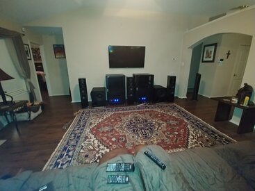

Okay fellas could use your expertise here. I have 3 options to go from for 3 new towers for my front 3.
3 SVS ultra towers, 3 Emotiva T2's, or 3 SVS prime pinnacles.
I'm reaaallly kind off leaning towards the Ultra Towers. But! This is where I need your help.
Here's a picture of the room
And with that picture here's the concerns.
Concern 1. If you look carefully there is tape where the towers are that is the best measuring spot in that room for towers. Slapped 3 different trios of towers in that room and each time its those spots they measure best in. 12 feet apart center tower equidistant in between the 2 all towers 2 feet off of the wall. My first concern is those low slung dual 8 inches on the ultra's I hear they need a lot of room to breathe is that enough room off of that wall? Because that wall can build up room gain pretty easy.
Concern 2. There is plenty of space with the prime tower as a center channel between the 2 AV racks. And there will be with an ultra tower there as well.
But! Will the Ultra tower in that center spot have issues with those side woofers interacting with those racks next to each side of it?
Now I've made sure the racks are about 2 inches behind the towers to avoid diffraction issues. But will the side woofers on the ultra's have issues in this setup?
If there are issues do you fellas have any other recommendations? With speakers or the other 2 suggestions I put up there.
Thank you for your thoughts and time
