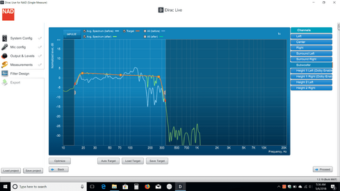

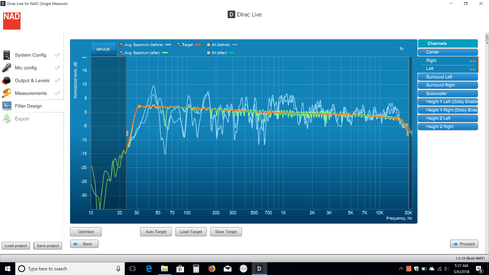

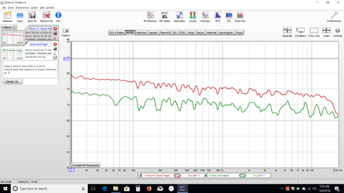

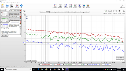

I would like to see some graphs comparing the two methods of implementing DL.

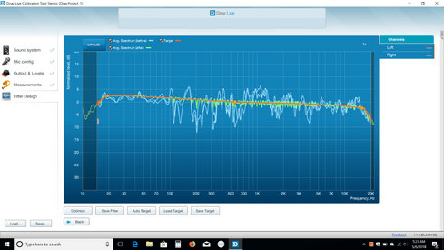

Then graphs you shall have.

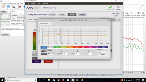

Added filter below to deal with the slight dip at 65hz.
Bingo. Mic got moved slightly so disregard anything above 350-400 or so on the blue line.
There are clearly some differences. At this point I assume intentional vs a "defect" in either the Dirac Stereo Tool or Dirac for NAD tool. No way for me to test.
The NAD version did leave a small dip at 65hz (IN MY SETUP) that was easily removed. As for the delta between target and result for the two tools, subjectively with these results, the NAD has a more "natural and open" presentation while still seeming to maintain the pinpoint imaging, where the Stereo version, if the mic locations aren't spaced over a 5 to 6 ft area, can sound a bit "over processed". To me neither sounds "better" than the other. Just slightly different.
This hissing is what I've read about elsewhere, and the only significant concern I have with this unit. Sonnie

Hmmm... it doesn't even look like DL is doing much on your response above 100Hz... the PC version looks like a much better response.
JStewart
Dec 5, 2017
2,078
Central FL
MiniDSP 2x4HD below 100hz. 3 subs. Eq'd with MSO. Not sure DL has much to do in that region. What I think I see is the overall response follows the DL target. There's just more deviation around the NAD target vs. PC DL target.
Question is is this expected behavior or not? Is @AudiocRaver still doing an evaluation of this unit? I'll bet he could shed some light. Or perhaps @Flak might have some insight?
What was the smoothing you used for the graph you posted at the beginning of this thread? I might change mine to match if needed and scale the Y axis the same to compare.

Looking at the average spectrum before on the stereo vs the NAD, it looks like much better native response in the stereo graph, and DL had less to do.
Are these the same speakers, placement and room?
JStewart
Dec 5, 2017
2,078
Central FL
The speaker and sub locations were unchanged.
The average spectrum is different because with DL for pc stereo the crossovers come after the DL's calibration signal and calibration filters, i.e. The crossovers were active during the calibration.
In the case of DL for NAD the crossovers are bypassed and each speaker is calibrated as if it were set to Large in the NAD. After the calibration the crossovers can be set to suit the needs. Needless to say with a small room the fronts need help from subs.
You make a good point with respect to working harder and it could be.
My own theory is its design intent. I'm leaning that way because the variance from target is more prounounced accross the entire response.
I feel like I need to say again that subjectively the differences are there but not affecting imaging that i can tell. It still sounds like I'd expect Dirac to sound, which is very good.
I think no and yes. I don't believe it is a design intent, but yes the variance from target is more pronounced. I was looking above 100hz, as was Sonnie. DL, can only boost 10db, at least with the 88a. If you look closely you will see why the greater variance from the target is there. I would bet it has to do with mic placement during the calibration.
Well at least I can rule that out. The mic did not move during either calibration and stayed untouched in that same spot for the red (DL for PC) and green (DL for NAD) REW measurements. The calibrations were a single point only at the MLP EDIT: REW was measuring the right front speaker.
10db max boost is true for DL for NAD, DL for PC, and MiniDSP NanoAVR-DL too.
5,195
It's hard to say what might be happening, but certainly it does not look right.
I don't disagree. I should have taken a minute to use REW for the full 9 point calibration but didn't. The unit is now packed up and on its way back due to the hissing sound from the height channels, but when its replacement arrives I will do that.

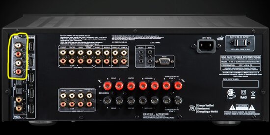

Dirac will process all channels on T758. That is 7.1.4
Good to know. I will see about using some active speakers to complete the setup, thus only needing the 7 channels of amplification from the T758 and no more. I already have a pair of Airmotiv 5s, and looking at the AVR, it looks like the one thing you can not power are Rear Height speakers - so that would be the place for them. I could then get a pair of Airmotiv B's (passive versions of the 5) for Front Heights. In this configuration, the Back Surrounds would be omitted, and I would move the Side Surrounds back a foot. Alternatively, I could power Back Surrounds, and go active for Front and Rear Heights. Please do let me know if you are aware of any limitations when assigning some channels to be active (pre-out) and others passive. I suspect not, since I assume many/most of you doing 7.1.4 are using these preouts to an amp:
So my choices are, Option 1:
Passive: Fronts (2), Surrounds (2), Front Heights (2)
Active: Rear Heights (2)
Option 2:
Passive: Fronts (2), Surrounds (2), Surround Backs (2)
Active: Rear Heights (2), Front Heights (2) (this would rely on being able to find another pair of used Airmotiv 5s, which isn't guaranteed)
Room is 17 x 10.5 x 8 with a single row of seats. What do you think?

Eric SVL - You're correct that both option 1 and option 2 configurations are possible.
All channels have pre-amp out.
"Surround Back" built in amp can be re-assigned to Zone 2, Height 1, or Height 2. That's the only amp assignment that can be done.
