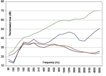

Take a look at this graphic representing the three primary regions of transmission loss. The regions are the stiffness controlled region, the mass controlled region, and the extension of the mass controlled region. These three zones or regions are separated by the wall resonant frequency and the material coincident frequency.
Notice the impact of damping. STC stops at around 4khz. The damping doesn’t have any impact in the midrange. Instead it reduces the impact of the two resonant frequencies and given enough damping can massively extent the mass controlled region. Fr(wall resonance) often falls at around 80-100hz in many 4-5” walls.

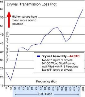

This wall shows the effect very well and is consistent with what you are considering doing. The main difference is you will use 16” OC studs which will raise the Fr a bit higher and thus constrict the mass controlled region. Notice the pronounced dip at the coincident frequency.

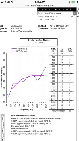

Here is an image from that same wall structure taken at Orfield labs.
They only rate the wall at an STC or 44 and this is with two layers of 5/8” drywall on both side and R13 insulation. Notice the pronounced dip at 2khz.
Now look at what green glue does.

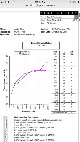

Same wall with green glue but that 2khz coincident dip has been completely filled in and the Lf resonant frequency has also been filled in. This was also taken at Orfield lab.
With the insulation test data, I would want to see actual lab reports from Orfield lab before I believe those numbers. They are much higher than reported in lab reports from independent groups and studies. Everything I just showed is completely consistent with theory. The increase in midrange TL is accounted for by the added mass.

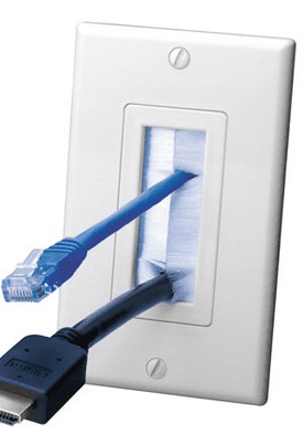

So it's time to run speaker wire in the theater, and I've been pondering how to terminate it at the speaker end. What do most people do?
I have thought that I should install a back box on the studs and bring the wire through there, then when the finish work is all done I could install a banana plug plate. Then when I install speakers, I could have a cable terminated at both ends with bananas and make the connection to the speaker that way.
Thinking about the same thing for subwoofer line-level connections as well. An RCA or XLR jack on the wall would allow me to have a length of cable between the sub and the wall, and I could maintain placement flexibility that way.
What do you all recommend, or what have you done in your spaces?

My wire just runs through conduit with no wall plate or wall termination. Just free flowing. That works for me since the equipment closet and speakers are all hidden from view.
Wall plates work fine, it's just extra termination. I personally don't like adding extra breaks in the cable like that but it's realistically a minor issue.
Conduit is good for running more cables. If you are like me that is a must, I'm always changing things. If that won't happen then a wall plate is fine.
