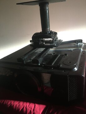

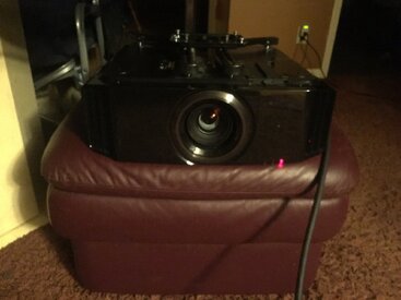

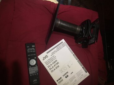

Picked up the PJ near Chicago last weekend, but put off posting pics until I could check it out. Since I don’t have a screen yet, I just used a convenient spot opposite a blank wall and ran it through a few paces. Menu items functioned properly, the motorized lens whirred from one setting to another, and the lamp seemed to give off enough brightness even without completely dim lights. The picture quality looked great as far as I could tell from the tan wall, lol.

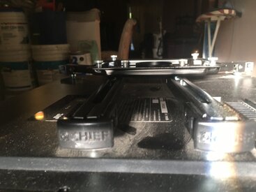

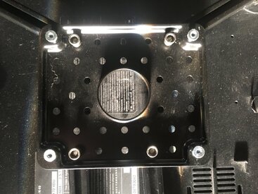

I know, right! Those aren’t pocket change. It looks like it’s the manufacturer’s model to me. It’s a dual system with rails bolted to the projector chassis (for horizontal movement?), and a curved, adjustable bracket on the mount (for pitch, roll, yaw?).
Im guessing it’ll be a multi-person project to hoist 35 some-odd pounds of projector and mounting hardware up to the ceiling and hold it here to be fastened down (or up as would be he case here, hahahahaha, I made a funny)!

When I have done it in the past... I attach one side to the projector, and then attach the other end of the mount assembly to the ceiling. Then you just lift the projector up, and slide the screws (which are attached to the part of the mount that is on the projector) into the slots (on the ceiling mount)...tighten, and you are ready for fine tuning the projector.

The projector looks GREAT!!!!! Awesome! Really excited for you. I think you made a great choice. JVC is killer gear!!!
I agree with @Negatron on the ease of installing the mount. Your biggest issue will be making sure the mount is anchored directly into a joist or held in place using another strong method.

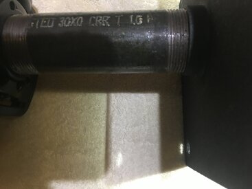

The threaded pipe on the mount almost looks like that was made/incorporated aftermarket. Doesn't look factory?

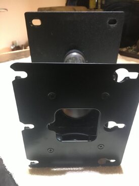

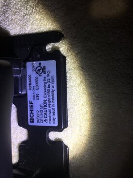

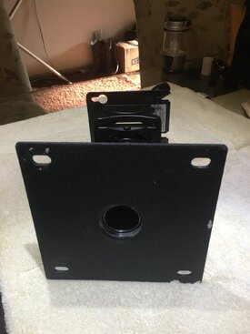

You raised my curiosity, so I looked at it more carefully. It’s not a JVC mount that I can tell. It’s a kit made by Chief. Here’s a closer look.
