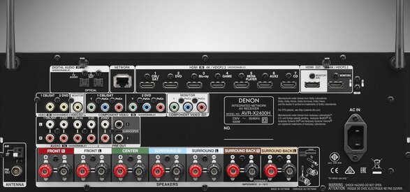

I want to follow your suggestion using 'a line output from the Denon,' as you said but looking at my receiver's rear panel, I only see: (i attached an image with my specific model backpanel)
  • ZONE2 pre-outs
  • Subwoofer pre-out
  • Speaker terminals
Would the subwoofer pre-out work for this measurement, or is there another way to measure the relative latency differences between modes with my specific model?

To use a speaker output you would have to set up a resistor divider to protect the 2i2 input. You could try measuring the sub output, but the effects of crossover and LFE low pass filters may make that challenging.

Yes, loopback as timing reference. Set the bass management crossover as high as it will go to maximise the bandwidth sent to the sub. Save all the measurements and post the mdat.
Won’t the bass management system and therefore the signal to the subwoofer be passed through the the Denon signal processing and possibly ADC converter if feeding analog to it?
If the OP is wanting to compare latency of “Direct Mode” (i.e. analog pass thru) to processed signals would he be better off using a pre-out? I don’t see a pre-out on the photo of the back panel. I would guess the zone 2 outputs will work. If I’m right about the objective than the OP could consult the manual to see what processing can be applied to the zone 2 outputs if any.
Then use the subwoofer output to measure the latency effects of processing if the unit won’t send processed signals to the zone 2 outs?

@JStewart I scanned through the manual and as i feared zone2 doesnt have audyssey nor any dsp mode (aka direct or others...), if i have missed something or if you suggest for me to try something else, i would be more than happy to!
