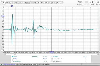

then I adjusted the delay settings on my DSP to time align the drivers and did a sweep. The crossover points look much better, and then I inverted the phase on one of the drivers to see if it would create a null at xo point. Sure enough it did. Then I checked the impulse graph and to my surprise, instead of seeing a single impulse (since they are now supposed to be aligned), I still see three distinct driver impulses. Picture attached. Shouldn't be a single impulse?

If the three impulses are correctly timed, there should be one impulse when working together. If there are measurements of the three drivers before correction, I can take a look. Attach mdat file here.

I think the impulse is ok now. I think I made a mistake measuring earlier. The thing I don't understand is the impulse before the 0 point. Is that the source signal itself, and the 0-point impulse the actual response? File attached.

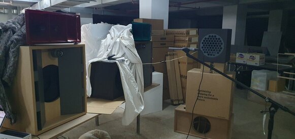

OK, I measured each driver with and without filters XO's on. I also did several full-range sweeps. I think the drivers are time-aligned now. At least they have the same delay value with respect to the reference speaker. Also, there is still a notch at around 800Hz, the crossover freq between the woofer and mid. I've tried many things but it doesn't go away. Also as per jtalden's suggestion, I tried to reduce the overlap between mid and tw by crossing the tweeter with a higher-order high-pass. I have included measurements with timing data. Am I on the right track? What can I improve? And generally, how is the full-range response graph? How can I remedy the notch at 800Hz?
I used a side speaker for timing ref impulse.
