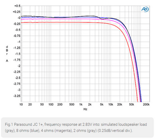

Amplifiers rated and testing into 2 Ohm loads will be better able to handle it but, as can bee seen on many Stereophile 2.83 volt sweeps very few amps maintain the voltage into 8, 4, and 2 ohms.
The A21+: Parasound Halo A 21+ power amplifier Measurements | Stereophile.com
41804
The JC1+: Parasound Halo JC 1+ monoblock power amplifier Measurements | Stereophile.com
41805
Distortion is increased with frequency where negative feedback is less effective but also increases with more difficult loads:
41807
The Megtechs regulated power supply could/should do better. Maybe they should send one to Stereophile.
