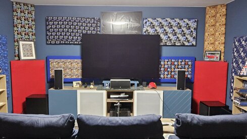

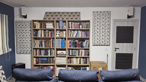

There is something strange with your setup, the crossover results are not optimal and the excess phase seems to be high.
Do you have any pics of your room?
Possible to move some stuff around?
I will try and take some pics tomorrow,no much to move around, thank you for looking into it :T But what causes the exess phase? the fronts at 11ohz are fine, as that is the best I can get in my room according to REW, but 150hz at centre is not, and the same for the rears and surrounds

here are 2 pics of my room, front and back
I have a feeling the only way to "correct" it would be to reposition everything, placement, re-run of Audyssey etc....but that's a total guess on my part.
Thank you for your reply, I'm not sure I could reposition everything, there's nothing to move:sneeky::sarcastic:
