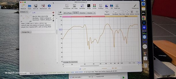

Great News for the users of Denon and Marantz who are using the Audyssey MultEQ Mobile app for room calibration.
Obsessive Compulsive Audiophile introduced "Audyssey One" which eliminates the complicated and tedious process of manual EQ to a simple "push this button" application for optimizing an Audyssey calibration with the help of REW. To proceed you required the MultEQ Editor mobile app and John Mulcahy's free and amazing Room EQ Wizard (REW).
This "Audyssey One" works for any configuration that the Audyssey MultEQ Editor App can measure and is covered from 2.1 to 9.1.6 including Auro-3D.
Below is the link for the YouTube video uploaded by the OCA and since upload he is responding to each one with their query.
https://youtube.com/watch?v=iU1ZBsru76M&si=pe41ERqXwOCQ2ZKU
Just keep in mind that you will get better results with max position measurements (8 positions and more) with the Audyssey MultEQ App. Better the calibration = Better the result. So ensure to get good measurements before processing.
Huge thanks to OCA for making this script and for constant improvement by introducing new versions of the Script (the Current version is Audyssey One v 1.1) and John Mulcahy's free and amazing Room EQ Wizard (REW) and making them available for free to all.
