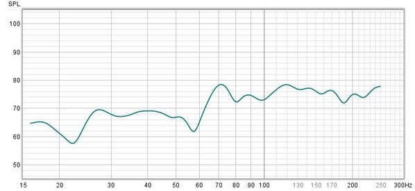

OK something is wrong. I just got another video card to run REW with and the sub is not getting sweeps like I did before the issue with the sub happened.. I think something is partially blown on the sub out on the AVR? here is my REW scan:
How can I test the Sub Out on the AVR anyone know how?

I was thinking maybe I am suffering from a balanced, unbalanced issue? would that cause low db in the low end?
Do you have another sub to try testing the AVR Sub Out?
Well I tested with another AVR the only thing I did not take out of the loop was the iNuke Amp.. could that go bad as to not have the bottom end? But on the iNuke it has 2 channels and I did test the other channel and I have the same problem.. so I am just at a loss as to what could be wrong here?
