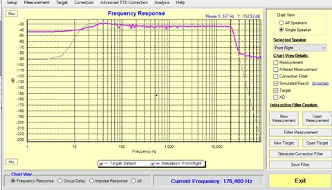

Well, Bernt. You don’t think I could leave well enough alone….
Since the measurements and filters we addressed above, I have had some physical room treatments. Specifically, we blew cellulose insulation into the ceiling cavity, strengthened the fake wall behind the mains and subs with 5/8” Sheetrock and Green Glue and installed large sound diffuser panels on the real back wall of the equipment space behind the fake wall.
I also have new surrounds, but they aren’t the issue at hand.
As you can see in the simulation before the treatments, I had substantial bass down to 18Hz. After the treatments, with new measurements of course, the bass falls off by 10dB+ below 30Hz. So, the bass now sounds anemic in comparison. It looks to me that there is plenty of bass in the lower register from the filtered measurement, but when correcting, even with the prevent bass bloat off, using a mid-frequency boost at 19Hz and up to 25dB of correction, I get the result you see above.
The fake wall behind the mains and subs vibrated significantly before the treatments and I’m sure the equipment room behind the wall acted to enhance the effect. I suppose that the bass is now tighter, but subjectively not as intense.
Your thoughts on what I could do with AL now? Thanks. JCR
